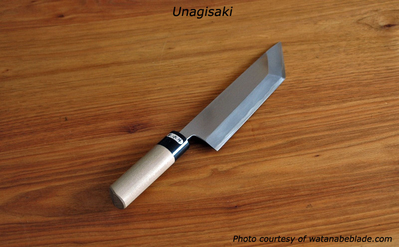

Hey everyone.
Before writing this post, I've been reading for about a week all the various threads and topics on here in Hope's of answering my question before posting. But I'm overloaded and need help.
I am used to making knives from 1084 and 1095 steels, but wont work for what the fishermen require.
I was asked to make a series of Spining/fish knives for a group of fishermen in Nova Scotial/Newfoundland. They use a peculiar type of slightly bent, single beveled knives, and they dont take care of them at all.
So, I wanted to find a steel that was very corrosion resistent as it will be in salt air/water every day...all day, and these massive guys who look like modern Vikings bare down on the blades, they wont easily break...especially at the tang. The blades have a hidden tang that goes into a slightly hour glass wooden round handle.
I have a list of steels, but cant narrow it down. In order of importance:
Corrosion resistance
Toughness in terms of blade handling
Edge retention (they will hone regularly)
I'm thinking a steel that can harden and temper nicely to 58 rockwell with some flexibility and "spring back", but not 1095 due to its corrosion performance.
So, what would you all suggest? Do I go with a N steel, or use 440c? Perhaps a clad steel would be best? Or maybe just use 420j2+
I'm lost.
FLICKR LINK TO THE PHOTOS OF THE REFERENCE KNIFE...CLICK THIS

The knife they want is sort of a modified unagisaki (eel knife and small fish boning).
Yes, you're absolutely right! It is a hybrid of the unagisaki and a Leather/Shoe Makers knife. I would do S35VN, I might try AEB-L and s35vn and make a few demo blades to test...only concearn, AEB-L will be a good price for a bar, after all the work, i can definitely sell it and make a better (but humble) profit, S35VN might raise the cost a bit too high.
