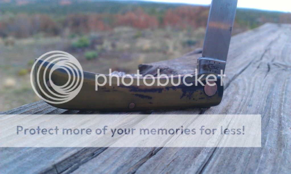

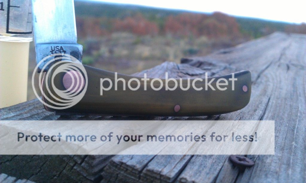

I've got a soddie jr. I keep in my tool box. I decided to try this mod this evening with some rit black dye that my wife had. It's not exactly what I expected. I guess it turned out sort of interesting. That's about the best praise I can come up with. I'll post my results when I get a chance tomorrow.
Ben
I find black dye raily works properly on anything - its almost always just a very dark purple
If anyone is planning this mod I'd stick to colours close to Yellow on the colour spectrum anything from red to green should work
I think I'll call this knife The Bad Banana. The splotches that are actually black are where a little PVC primer got sloshed on it.
Ben
