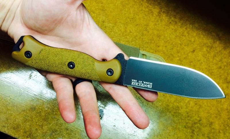

Woah, why the heck did I wait so long to buy a bk16? This blade just feels like it is the perfect size. It is probably the handiest lightest blade that I have owned. I was pleasantly surprised by the sheath. I am looking forward to bringing it hunting with me, and bet that front pocket will come in handy. I did not like the rough coating on the blade and the edge although sharp had pretty deep grind marks and could use some improvement. I don't consider a knife mine until I sharpen it anyhow so I had to get right at it!
Mods I've done:
-Sanded the finish on the blade completely smooth (usually I'd completely remove it, but I like it on this blade for some reason)
-Convexed the edge to hair shaving sharp
-Sanded the edge of the spine to allow fire steel striking
-Stippled the brown scales and put them on
I LOVE THIS BLADE! Do not hesitate to buy one if you are still considering it. You will find it to be a very light and practical blade. I have a feeling this knife will be at my side this hunting season and many to follow.
Looks good. I'm not a fan of the rough surface and thought about sanding but hesitated. Looking at yours I don't see a reason why not.

Love what you did with the scales. Classy.

While I have a wish list of mods to do but so little time, I want to make some scales. Made some crashcarta but the stippled scales look great

Great job on the stippling. Did that to mine as well, and it made a world of difference. It's an awesome knife, enjoy it!
Mods I've done:

Could you share how did the sanding, what grit?

Thank you. Since I didn't want to remove much of the coating just polish it smooth I went with 400grit with light pressure then after that smoothed out I went to 600grit. It did not take long since I was only trying to sand it smooth. I then did some final smoothing work with 1500grit. The coating is slick as silk and still provides protection for my steel.

Damn fine job there!!!! What grit did you end up using?

Lovely work on the scales and finish, too. :)
