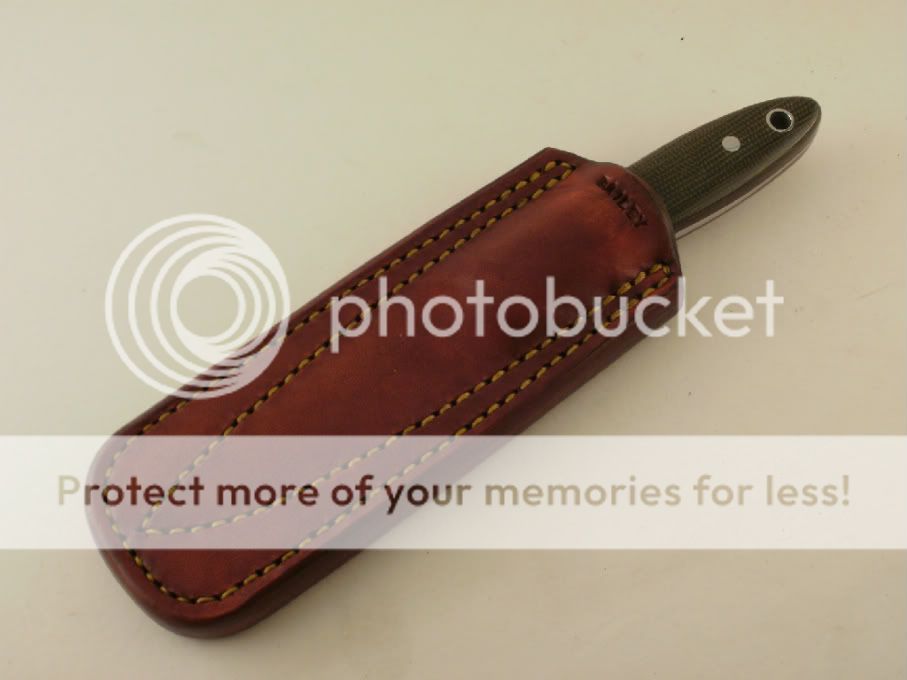

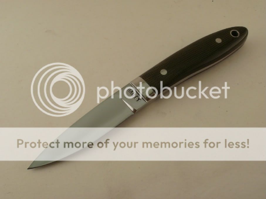

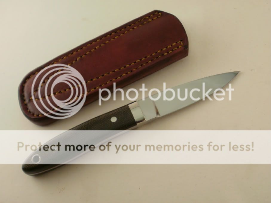

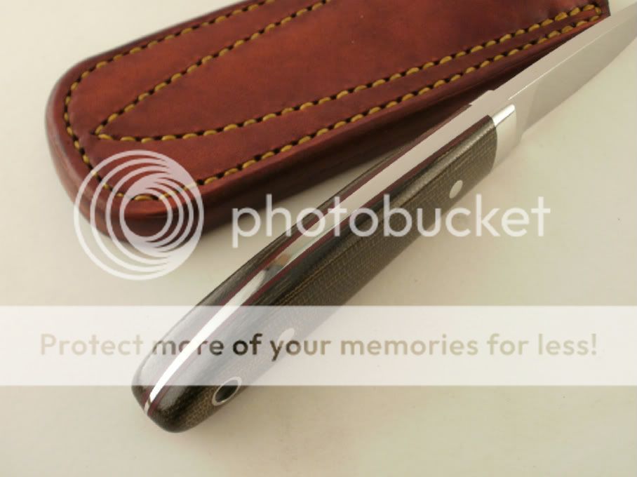

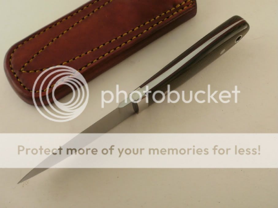

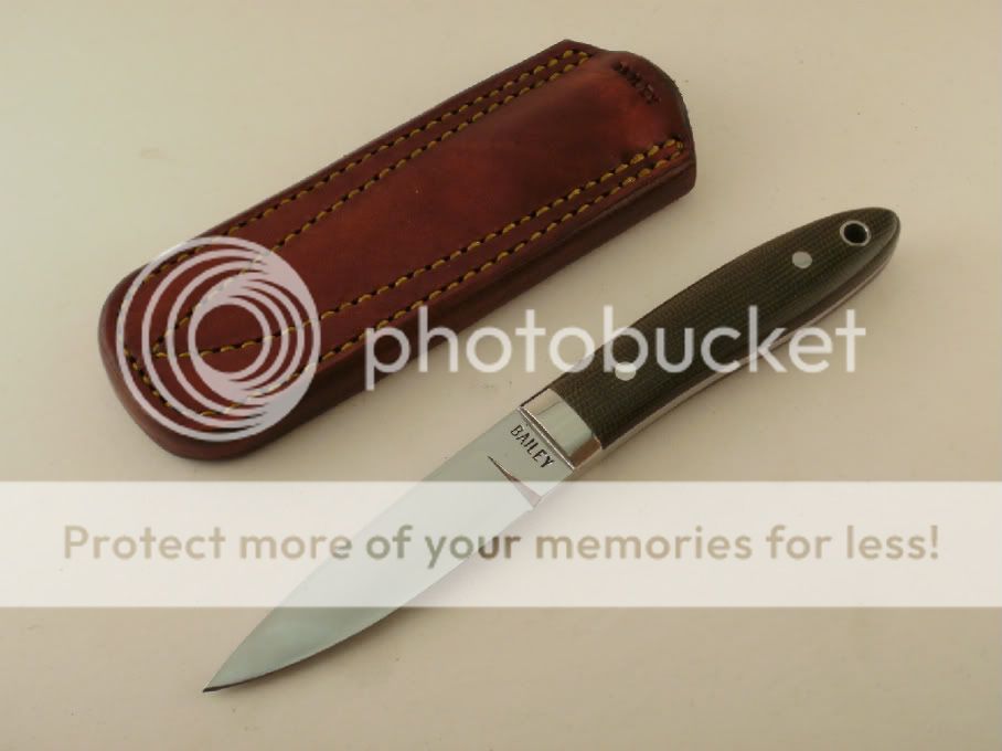

Just about finished this one up tonight....couple of minor things to sort out, but pretty much done. It's going to be my new work knife, so I'm not too fussed to be honest.;)
Blade is 3" 80CrV2, overall length 6 1/2". Green canvas Micarta, red fibre liners and 303 stainless fittings.
One of my aims with this was to make it lightweight, and with thin stock (.157") and a tapered and drilled tang, I've managed to get the knife itself down to 2oz.
As always, thanks for taking time to look.
Ian.
