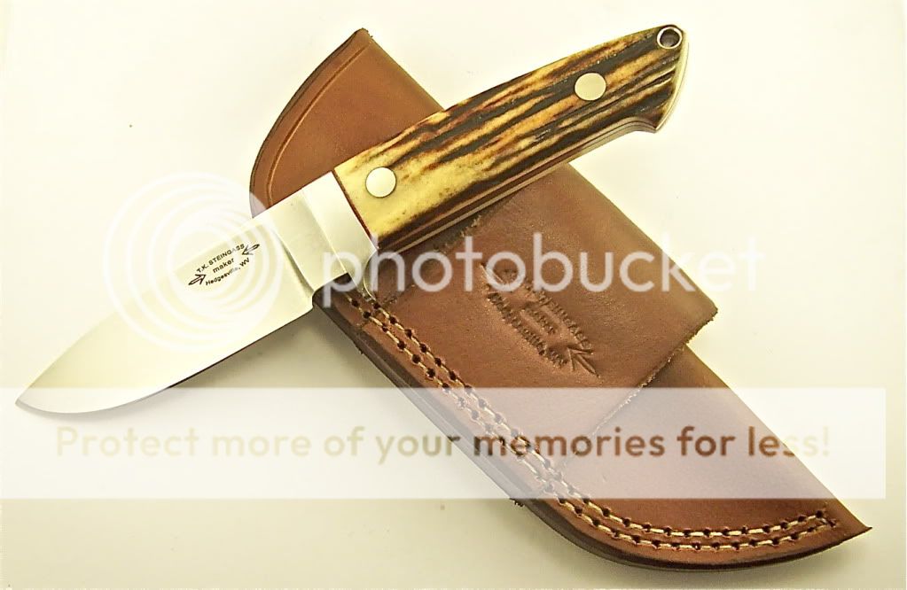

Hi fellas:

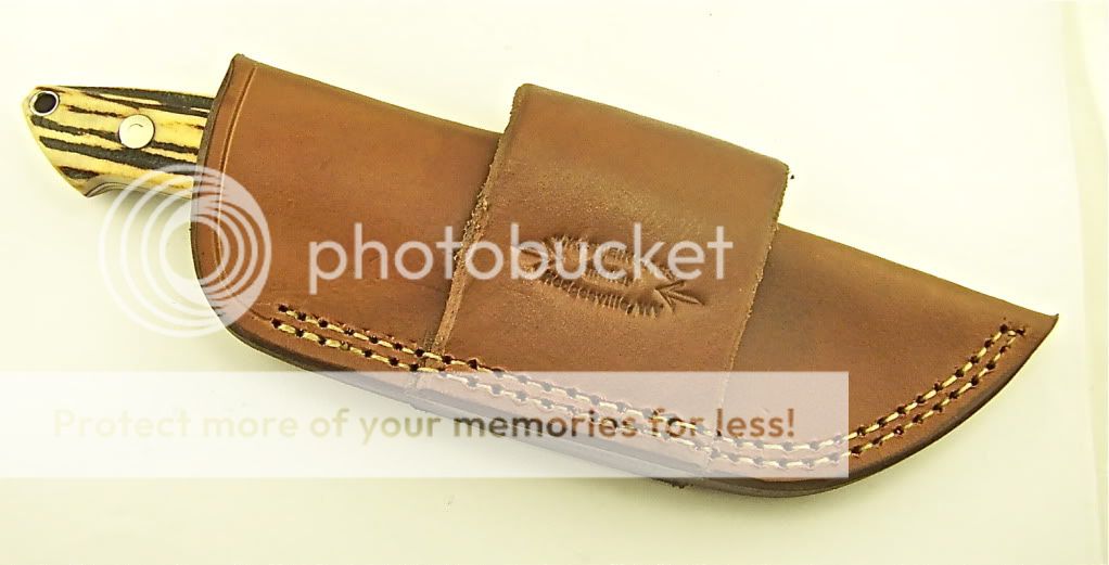

I just finished this Loveless style drop point hunter for a customer, complete with a horizontal carry sheath.....he's going to be wearing this rig on his gun belt at cowboy shoots. I hope you enjoy the photos.

3/16" CPM 154CM stock
HT to Rc 59-60
4" Hollow ground blade
8 1/4" OAL
Satin finish
Premium sambar stag scales
Brick red liners on tapered tang
Stainless furniture
8-10 oz horizontal ride sheath
Fellas: Thanks! Glad you like it!
Yep, I hate working stag and it's so darned expensive - just the material alone was $65.00 - it's getting up there - I know one maker that automatically adds $150 to the cost of a knife when stag is ordered.

If that bolster is soldered on like I think it is...that is a very clean solder job!! That is a beautiful knife. Bob would be proud!

Thanks Melsdad!! The guard is pinned and a lot of time went into that solder joint.
