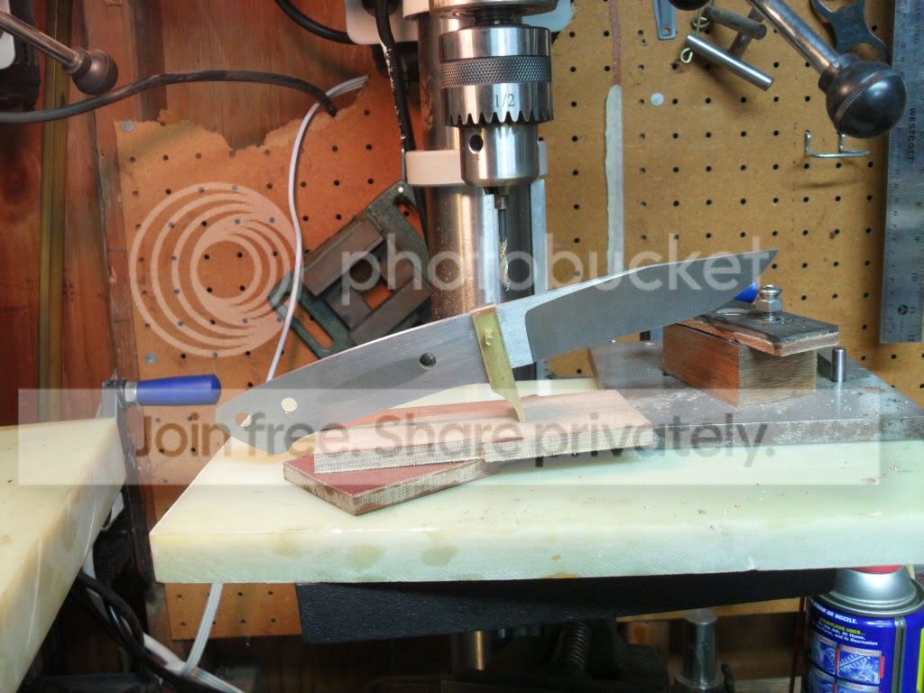

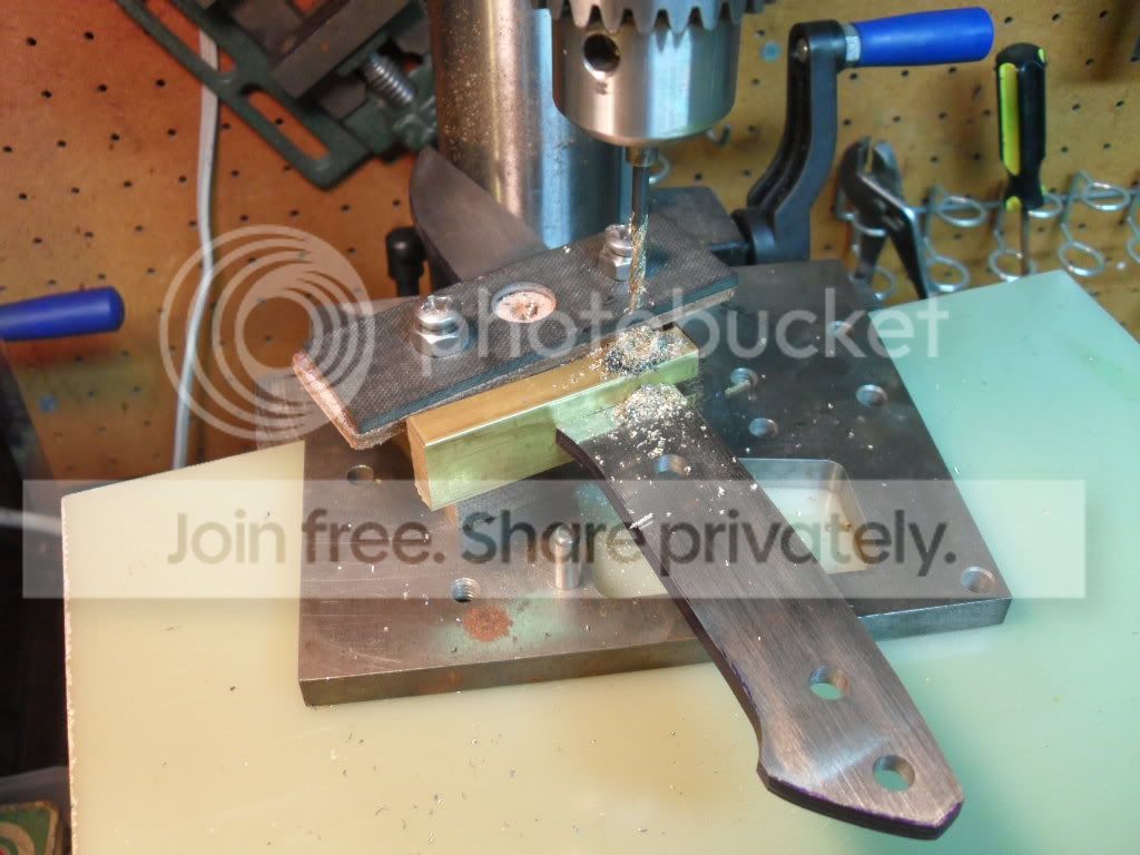

Hi all, Been busy in the shop as of recent and puutin together a batch of goodies to send off for heat treat. I did my first show this year and got invited to grind a blank that would would be part of an award in next years show, im a big fan of Loveless so i was really excited to hear they were cut from a true shop pattern, anyhow heres some shots of the initial work and first grinds, and fit ups.

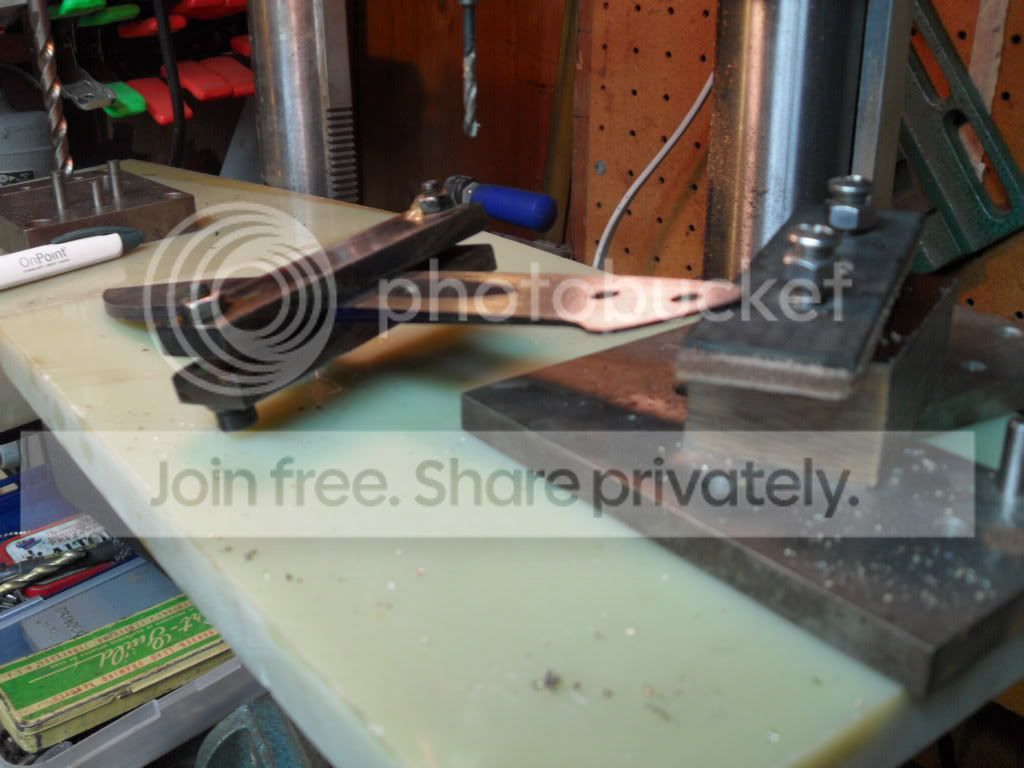

drillin the guard
side shot of taper, and rudementry stop

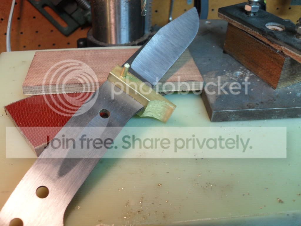

initial guard pin and fit, and will be soldered
Greg
Looking good, does the taper for your tang start right behind the gaurd? Also do you have a jig for getting that right or do you mark it or eyeball it. All the grinds on that blade are looking excellent.
It starts right behind the guard, i scribe a light line for reference after fitting the guard and then just eyeball up to it and that happens at the very end. Ill square the scales, fit them up to the guard meassure my gap and file fit the difference off the bottom of the scales if that make sense? Thanks for the grind compliment!

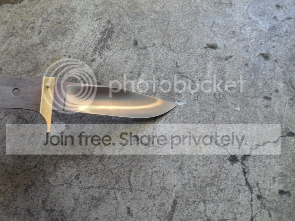

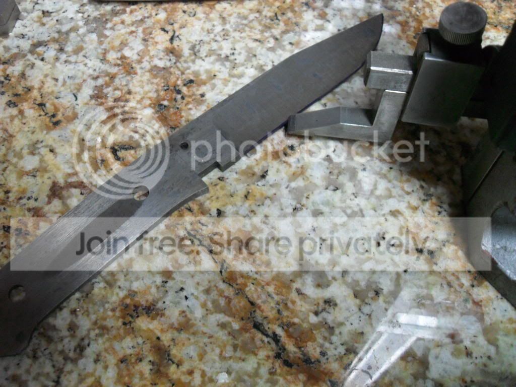

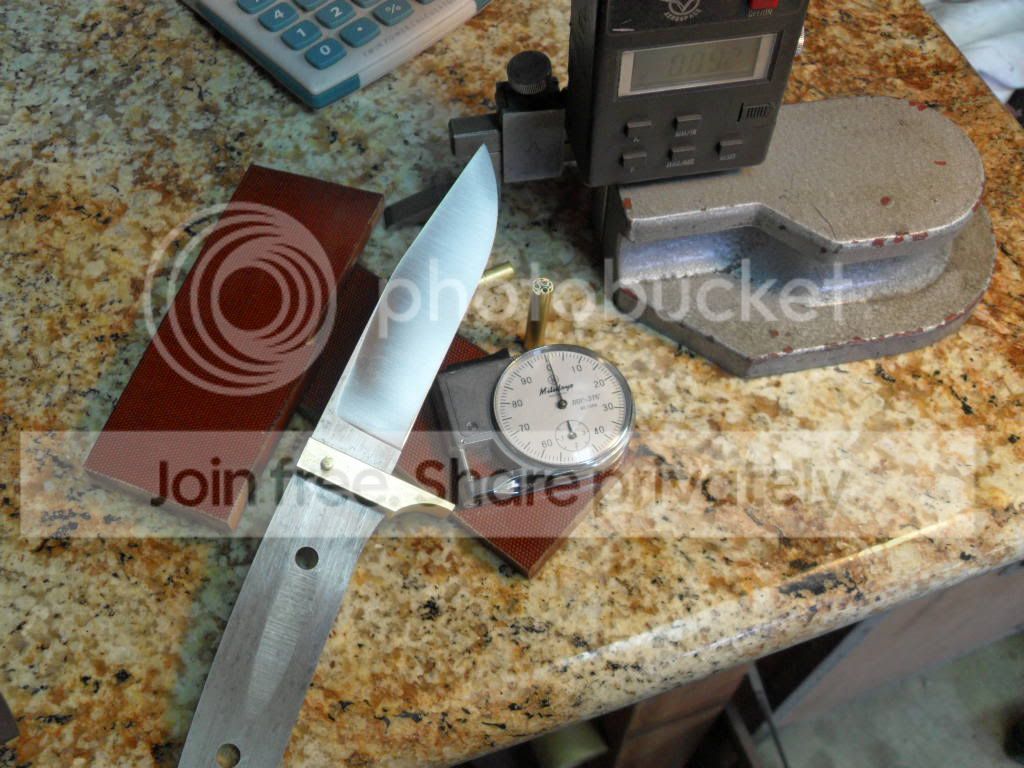

So here she is back from her salt bath, she got to bath behind some real monsters up at the Wheeler compound, but any how came out gorgeous, straight, and RC'd at 58-59! In this shot ive dykemd the edge, set up the heigth gauge, figured center with the aid of a calculator set my scribe and established center so that i could have that reference point.

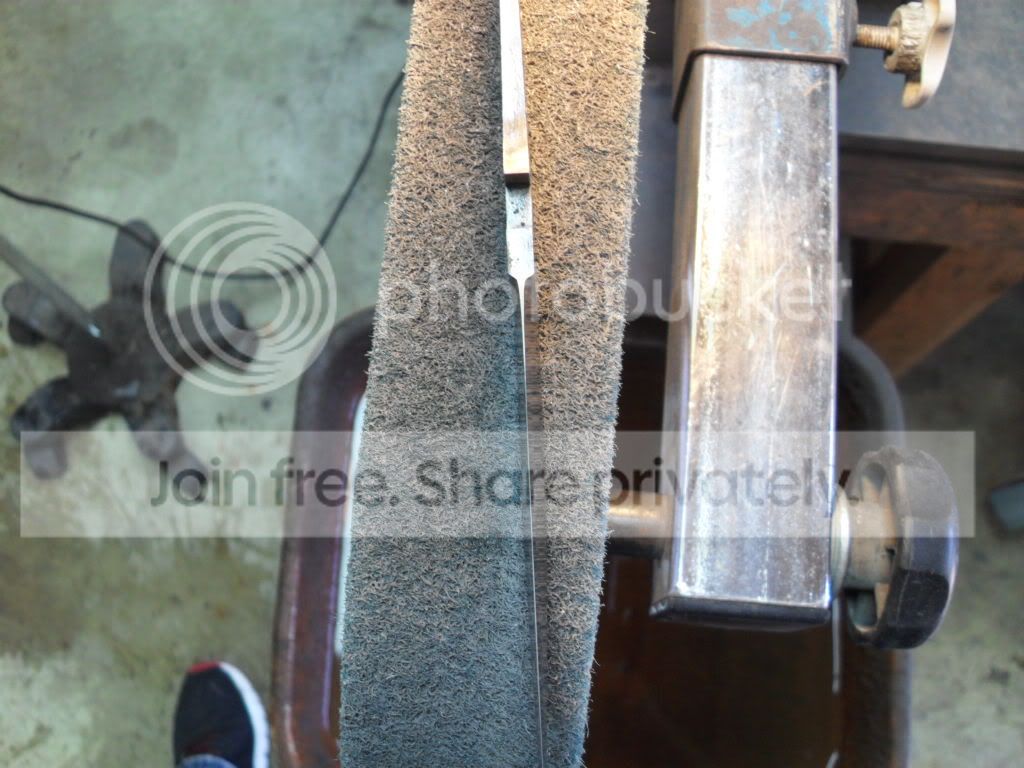

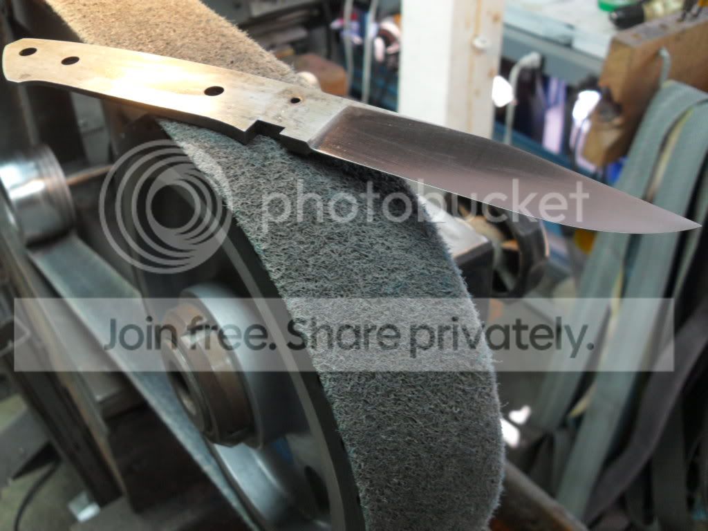

Next is after ive gone from 120 to 220 then a 440, then scoth brite i do use cheap and good belts in combo.
next is plunge shot its final thickness is .010, little thicker at the tip.

Heres she is next to some micarta, with mosaic pins, it'll get red liners and a brass lanyard tube. Next step clen up for solder...GULP!! Stay tuned folks!

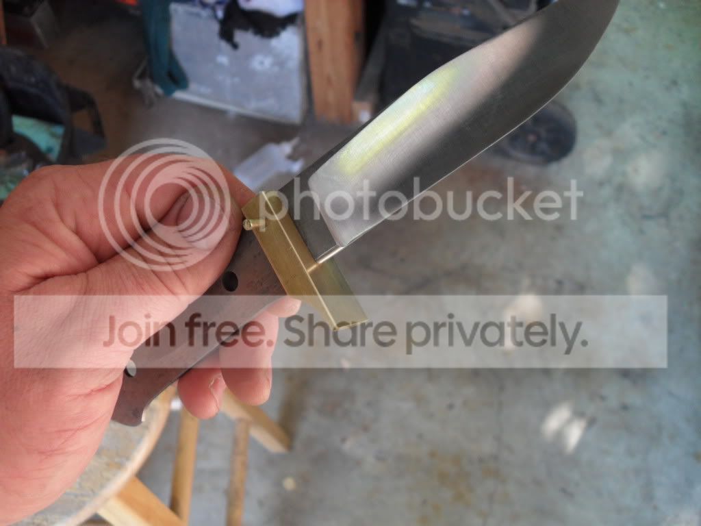

one thing - the ricasso area needs to be rounded. Bob hand filed a radias from the blade to the back of the guard so his milling radius of the guard matched the ricasso. He slide the guard back against a square stop to mount the guard.
Very true, and thank you for the reminder!! Luckily for me i can take the guard off and complete that radius.
Thanks again Argel!!
Striking difference for sure, may need a bit more, I know theres a actual gauge out there, but im not in the know. Anyhow heres the goods!
Sorry to disagree but that is not correct.
All hunters have a square ricasso. Fighters (except the chute) have both top and bottom of the ricasso radiused.
Are you guys talking about the radius that appears in the a last photo that Greg Haile posted? That the edges from where the blade ends at the plunge to where the guard is located has a radius applied?
