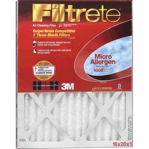

I have several box fans in my shop with some 20"X20" filters on the draw side They are held in place with some angle aluminum that is screwed into the fan housing. They do a remarkably good job for just a little $. The filters I use are a bit nicer than the budget filters.
They look like this...
I change them when they get full.
