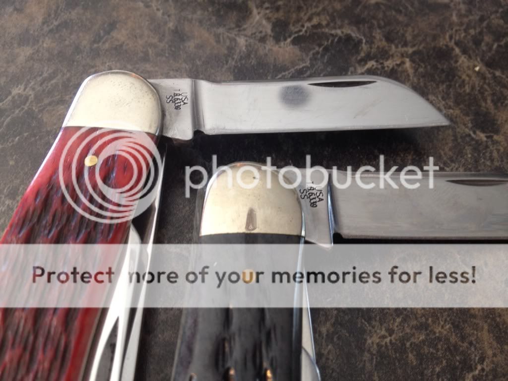

I know I remember seeing this on a thread somewhere. Either way I lowered the ride on the sheepsfoot blade on a couple of stockmans. I liked it and figure I would share the results. The target/foot of the blade that contacts the back spring when closed was trimmed with a Dremel. It now sits lower.

I agree absolutely. Also, a lowered Sheepfoot gives a better in hand feel too. You have to be cautious with the lowering process as it can interfere with the springs if overdone.

In the first photo below, you can see the amount of steel taken from the kick of the sheepfoot (left side) compared to the stock kick on the spey, seen at the right side:
