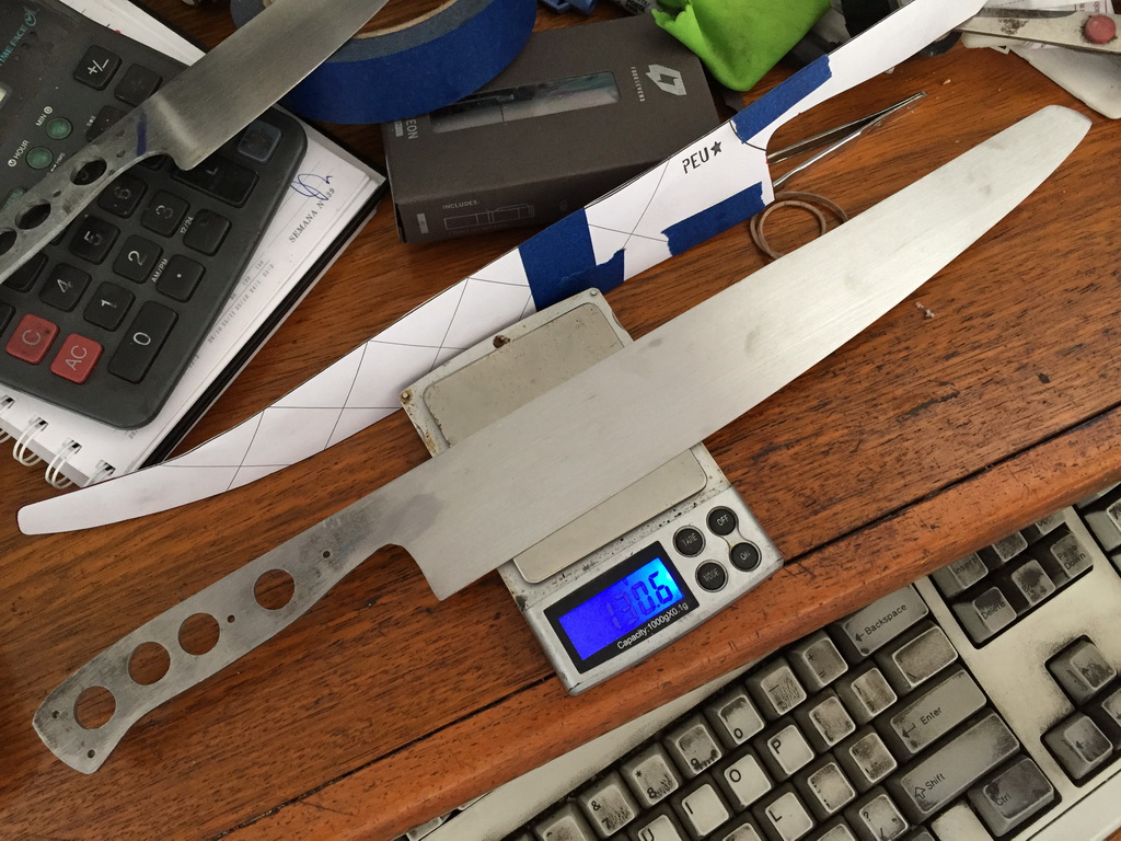

Im making this knife for a friend who is a professional pastry maker (don't know the right word sorry :) ) its 3/32" thick and the blade is 11" long so I need to activelly deter the decarb otherwise I would end with no metal...
130 grams / 4.6oz One of the specs was less than 200grams so Im on spec, the shape was decided by a 50 years old knife he uses and has the tip broken, he loves it because its lightweight and can be used as a spatula too :)

Knifes were hardened succesfully, blades are tempering now, I think the slurry worked because I measured hardness and it was around 62-63 RC, when usually O2 hardens to 64-65 out of the oven. The difference I guess is a very thin layer of decarb, far less than a test piece of the same steel I hardened afterwards. On the slurried blades there was almost no scales.
I used pottery clay, purchased at a local store very very cheap.
The long blade came out fairly straight, right after quench I put it under weight on a flat surface, that helped for sure.
