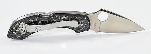

I recently got a Dragonfly 2 with Nishijin scales and it came with a spoon clip that I do not like. Can you make a lowrider clip for this knife and would I need to send you the knife to have the clip made? I think this is the same clip as the stainless dragonfly. Have you make a clip for one of these before?
I would post a picture of my knife but I've already managed to break the clip that came with it (don't ask), so here is a photo from a quick internet search to give you an idea of what the original looked like.
nishijin by senorsquare, on Flickr
Hey Steve,
No I don't recall anyway. Is it the same clip as the Lava? If it is that is the standard three hole original pattern basically. I think its hole size may be Japanese so its smaller than the 2-56. Or heck it may be the one that is bigger. I have not looked in a while. I'm also not sure if I have a Dragonfly or not. I get those mixed up. It may be a Lady Bug I saw in there that a customer gave me some time back. I was going to give it to the wife but it never made it that far and I don't think it has a clip now that I think about it. If it is the same pattern as the Emerson, Benchmade Griptilian, Lava, Calypso Jr. original Manix and many others in the industry I can make the clip without the folder needing to be here but I have to warn you on smaller knives the low riders can be noticed a lot more. They stand up off the folder some so on a big folder like the Para 2 it is not noticed. On a little guy tho, it can be almost obstructive so it depends on the size a lot for comfort. The low profile of the clip on it may be comfortable compared to a low rider if its too small.

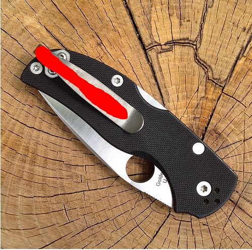

One thing I dislike about the stock clip is that is obscures those nice scales. Can you slim up the profile and maybe make it a little shorter as you are looking at the handle straight on? Like skinny necktie as opposed to wide necktie?
I'm not sure what your limitations are on how short and narrow you can make the clip. Here is a photo of the Native clip I got from you with the area marked in red that indicates the approximate size I have in mind.
EDIT - I checked and the hole spacing is the same as the mini-griptilian.
Capture by senorsquare, on Flickr
There are concerns for length change as it is possible I could put the lip in such a place as to make it poke so being you want it custom length and width I'd have to have it to do one that properly fits. I know it sounds strange but a 1 and 3/4" clip could be more uncomfortable than the length on it now probably closer to 2 and 1/8" or more. So effectively what we would be doing is moving the clip and hence the lip where it slides over the pocket. If that new position is such that its right where you want to put a finger to wrap the knife when gripping it could be for naught.
