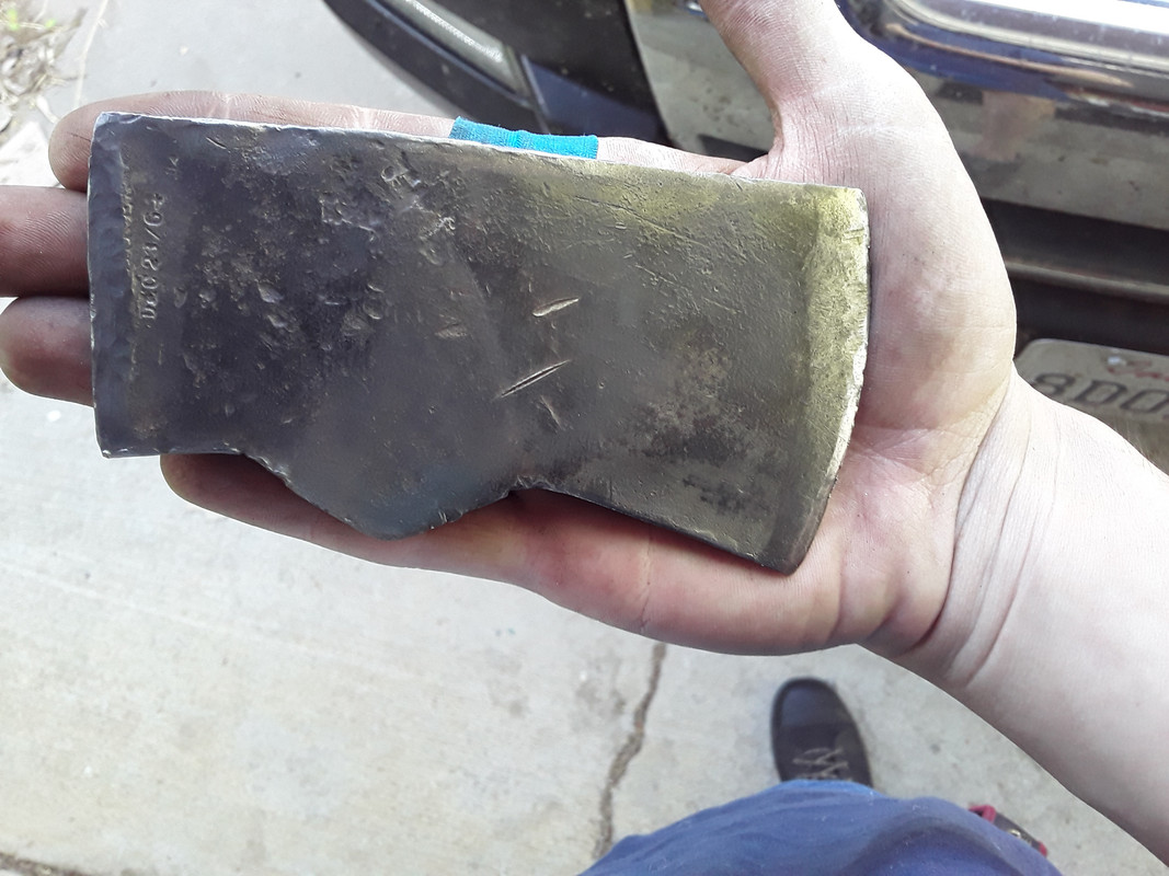

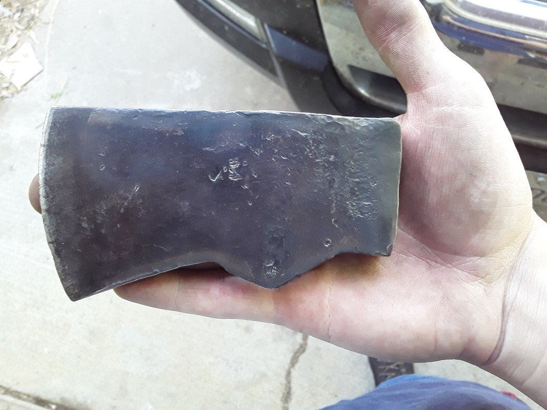

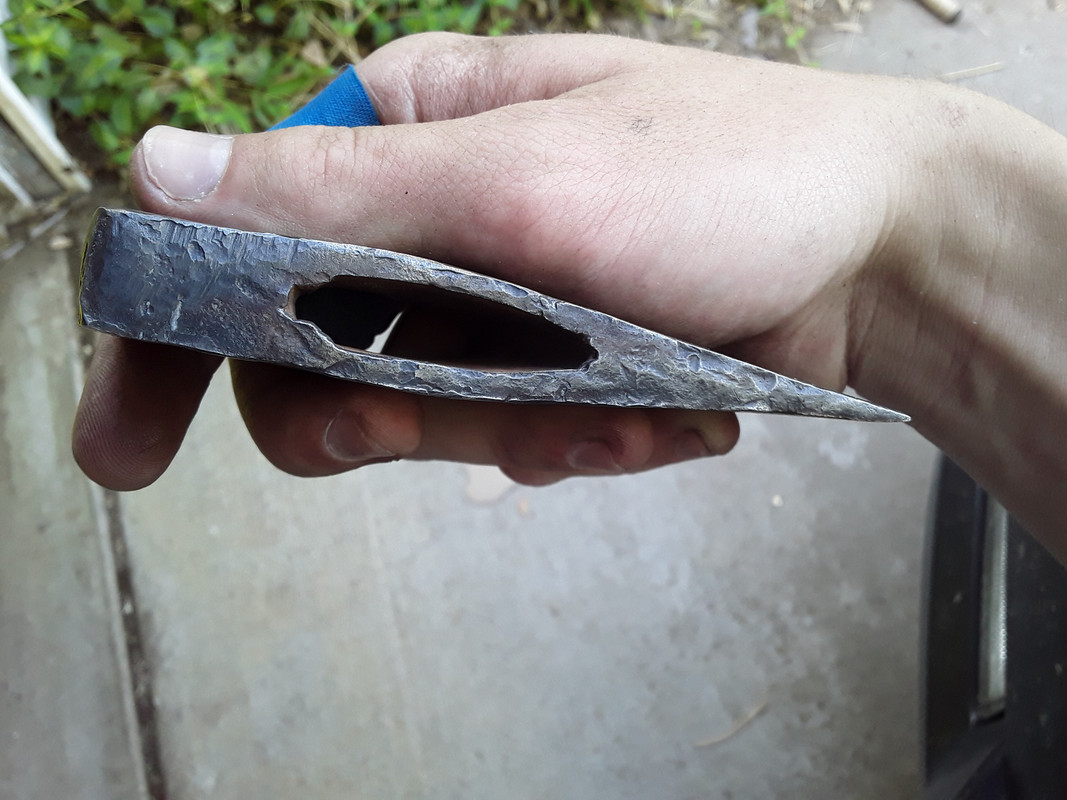

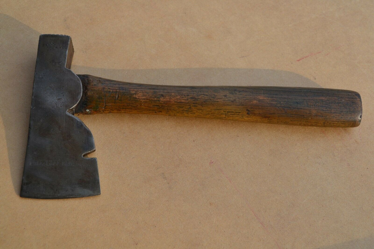

I did do some minor grinding on it but was overall as conservative as I felt I could be, though I accidentally removed the majority of the name which really hurts
. I just had to alleviate some of the abuse this poor little head had suffered.
At least I know what it said, I still have the picture I could possibly print and save , and I never plan on selling it anyways not that I expect it to really be worth all that much.
So here it is.
I pounded back what I could with my 14oz ball peen, took the cordless angle grinder to most of the remaining damage,finished it off with the ball peen, then used a few heavy applications of cold blue to blend in the light steel some.
I will probably slap some on the area and leave it over night to rust a little in the hopes I get a bit more of a matching patina under the rust, it certainly couldn't hurt anything.
I left no obvious grinding marks which I'm happy about, and neither the repair nor damage sticks out like a sore thumb which was my goal.
You can tell if you're holding it, but not from a few feet away.
