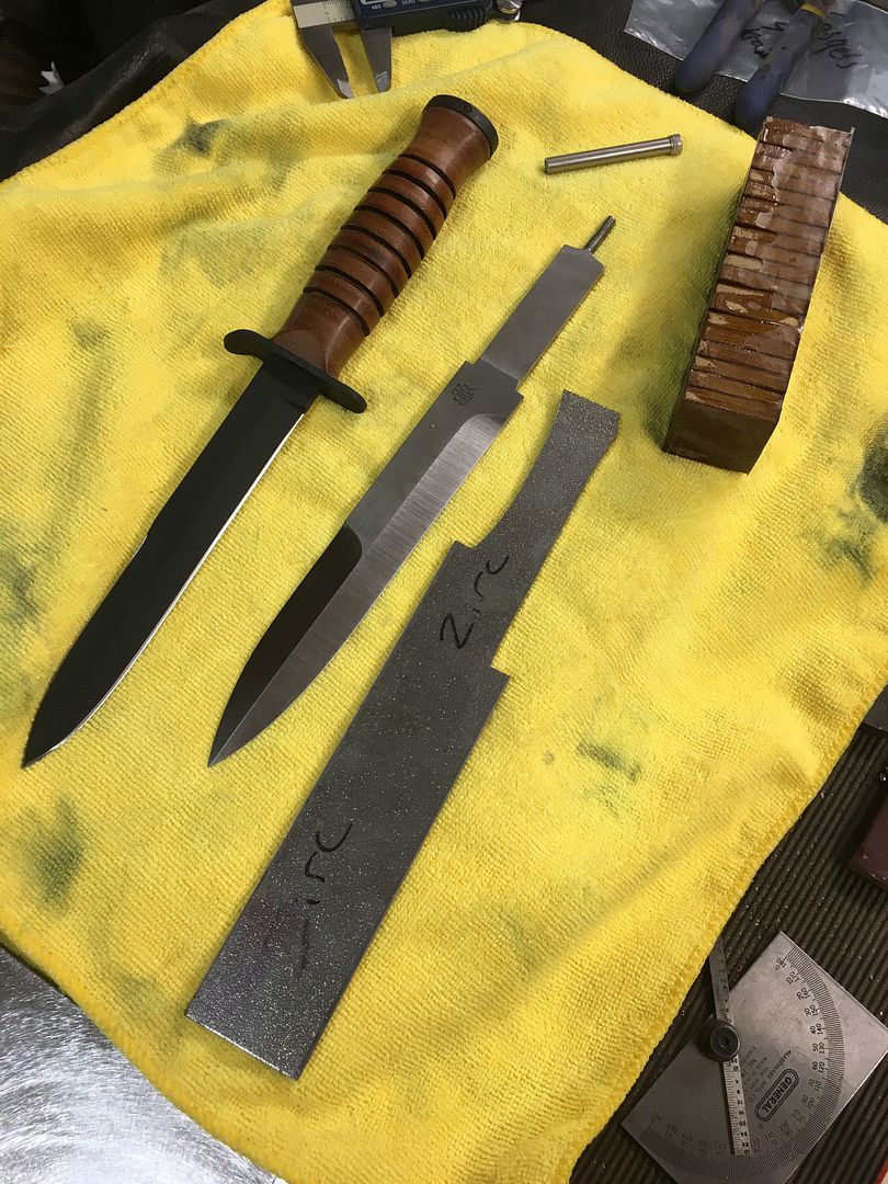

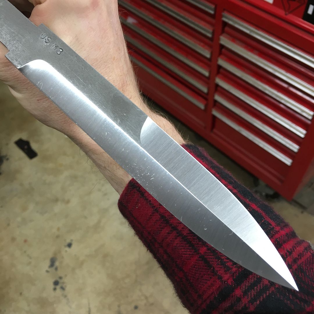

Hey guys, I am currently working on my version of a M3 trench knife and I figured I would take some pics along the way. This will be first try at a threaded takedown. Shout out to Karl Andersen for his wonderful videos he recently did documenting his process. It was very helpful, and mine will work in a similar fashion.
Here's what I have so far.

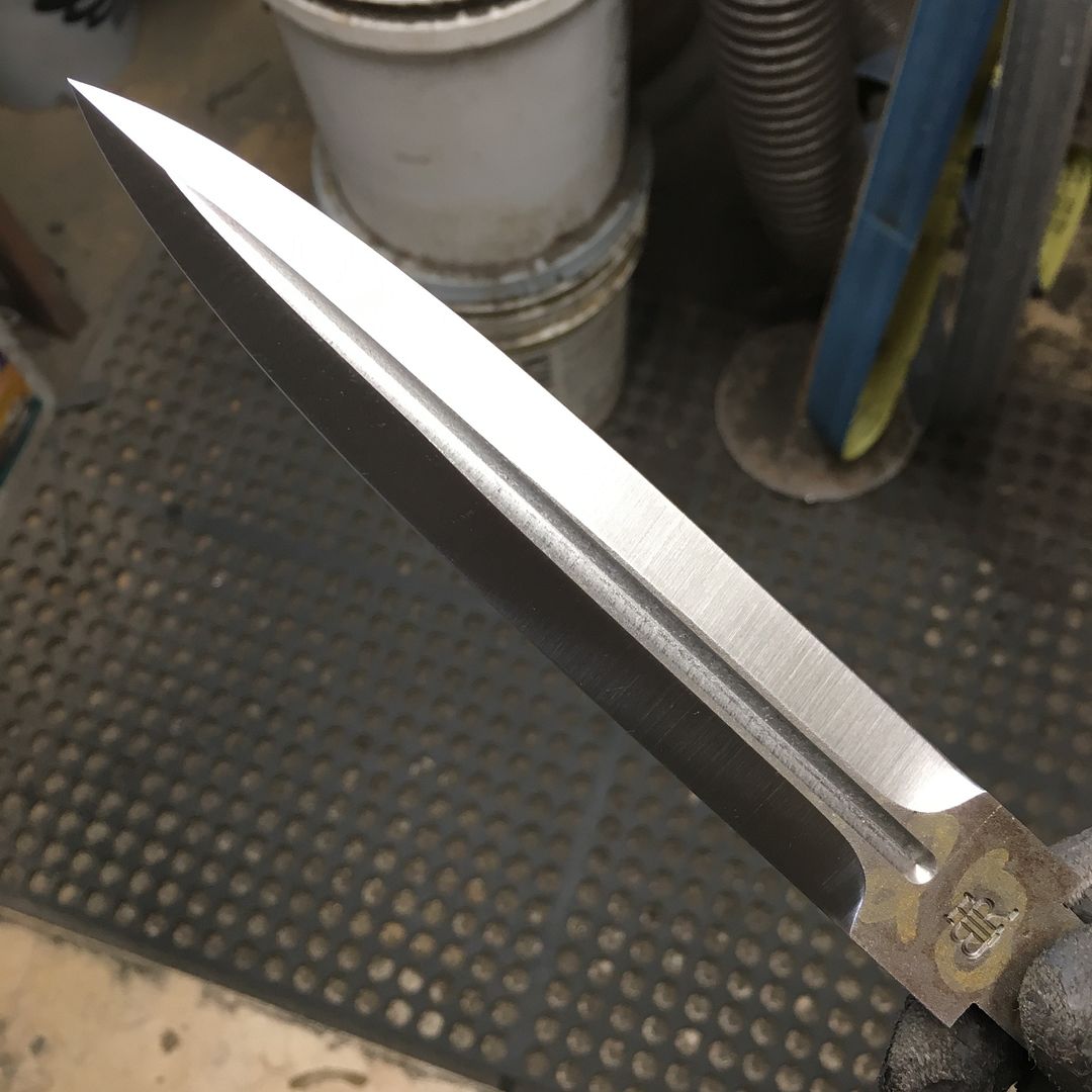

The blade is CPM 3V and will have my high performance HT.

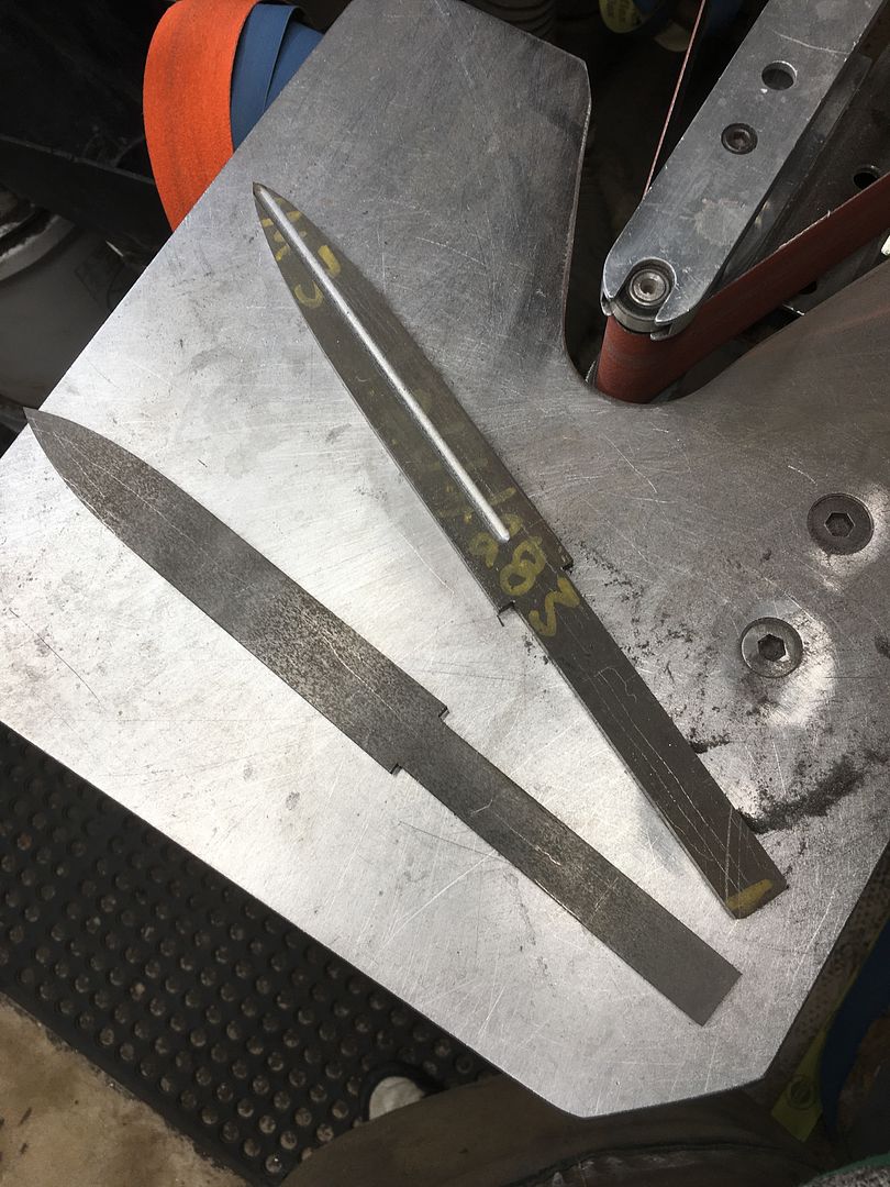

I'm working a full dagger as well. 😎

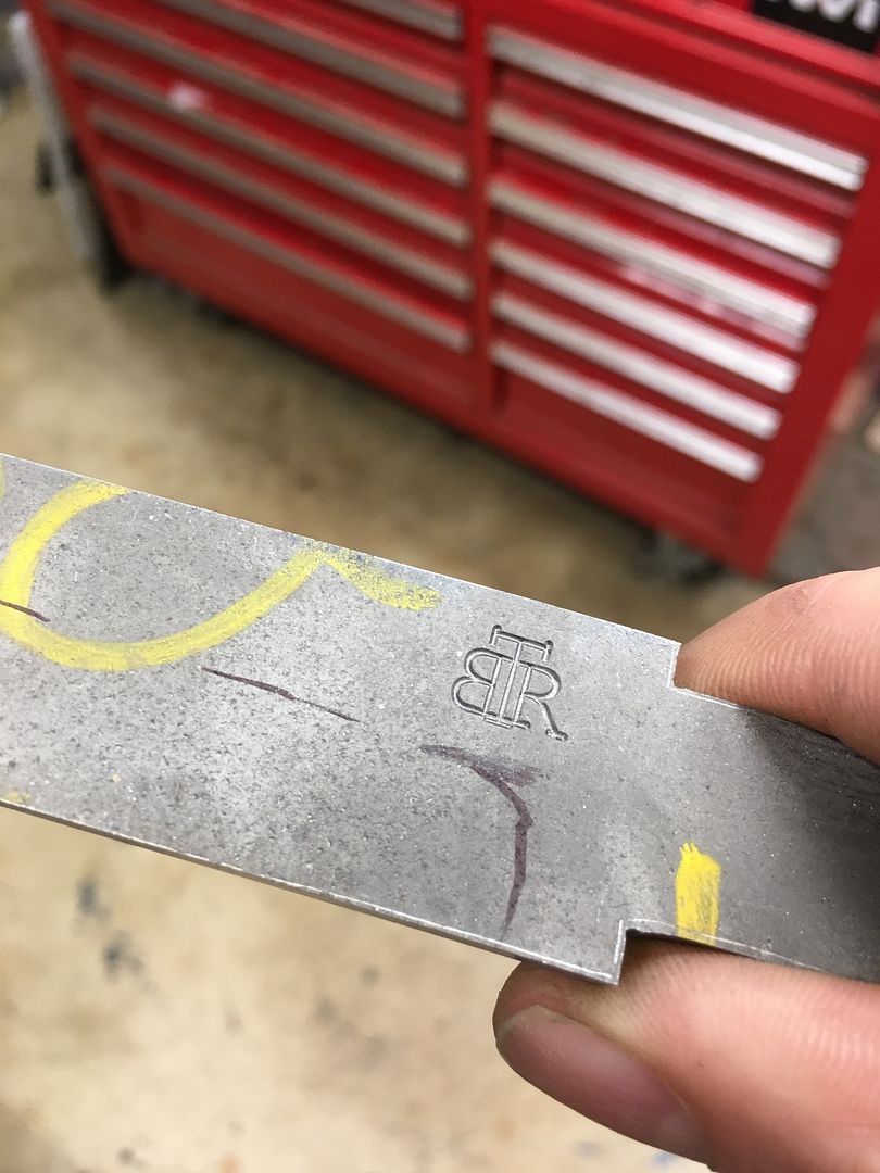

Hard stamped, because old school!!

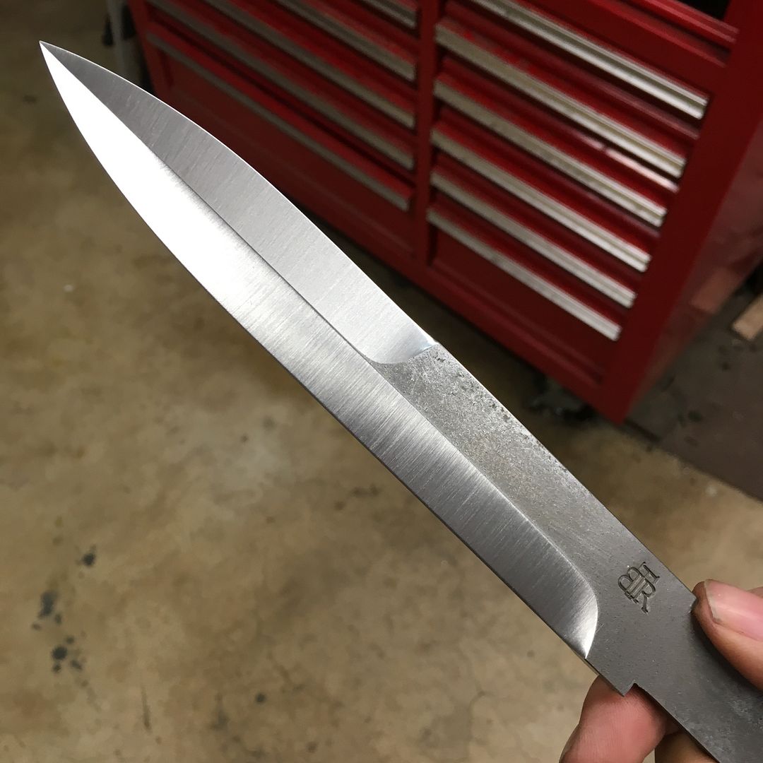

Rough grind.
Refined.

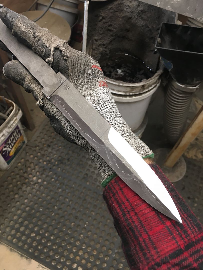

The tang is ready to thread here.

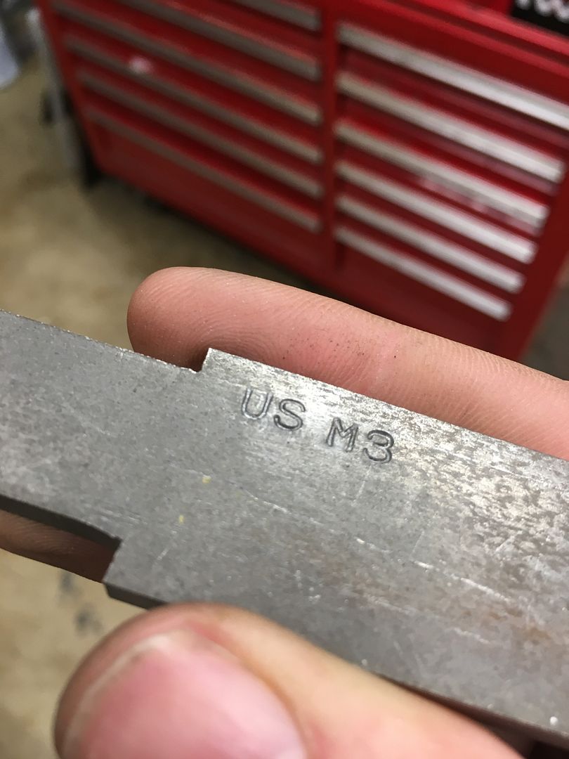

I figured I should probably show this one too. :cool:

The M3 has about 6 7/8" blade and the dagger has about a 7" blade.
Handle length will be almost 5"
The M3 is close to original thickness at around .210" and the dagger is .285" thick.

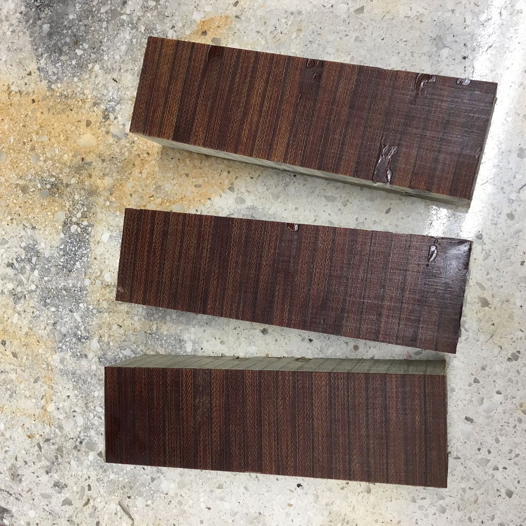

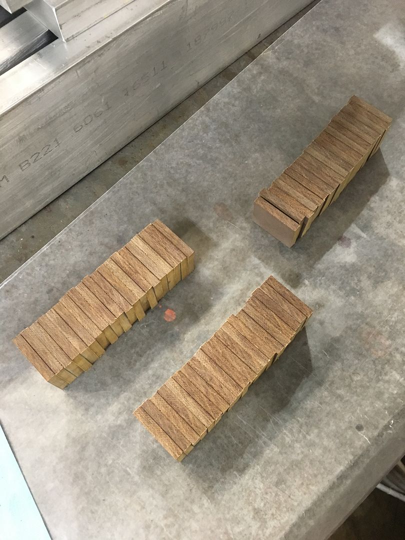

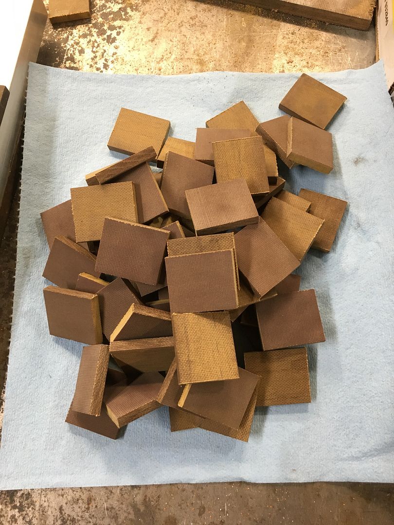

I decided to simulate the original stacked leather handle with stacked natural canvas Micarta. A bit of work just to get a solid block I can start to make into the handle.
Figured I'd make up a couple blocks while I was at it.
A look into where I am headed with it.
Cleaned up at only 50 grit with a little oil.
