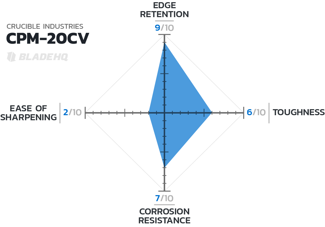

CPM20cv and m390 (and CTS 204p) are virtually the same steel... given the same heat treatment, they should perform the same.
*edited to add:
Bohler Uddeholm M390
Bohler M390 is widely revered as being the best all-around knife steel, which has led top companies to widely utilize it in higher end knives. M390 exhibits excellent edge retention, corrosion resistance, and high level toughness.

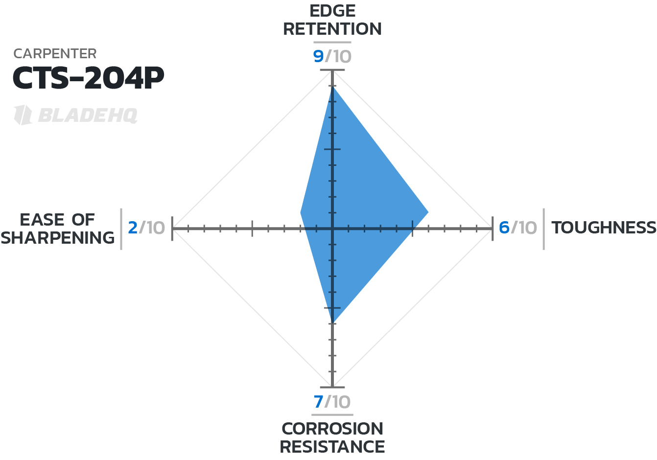

CTS-204P
Bohler M390, CTS-204P, and CPM-20CV are all essentially the same steel and sport a near identical composition. With significant amounts of Chromium, Molybdenum, Vanadium, and Tungsten, these steels are 100% ready for action. CTS-204P is made by the USA-based Carpenter Technology Corporation and CPM-20CV is manufactured by Crucible Industries.
CPM-20CV
CPM-20CV can be found on my knives today and is made by the USA-based Crucible Industries. M390, 204P, and 20CV are all durable steels that sacrifice ease of sharpening.

M390, 204p, and 20CV are the same composition made in different factories. None of them are particularly tough.
