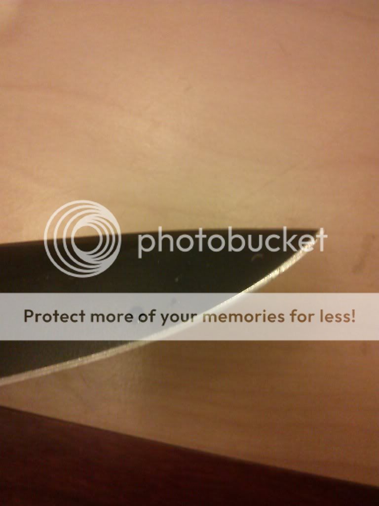

Considering the Contego is cerakoted, I doubt rust will be a problem.
Unless you go swimming with it in the ocean.........Which I've done ;)
After 2-3 hours in the Atlantic
After a wipe down and a dry, this is all the rust that stayed on (which rubbed off the next day)
Wearing my Gayle Bradley IWB while working on a hot day, I developed significant small rust spots on the blade which have been very hard to remove. I really like a lot about this knife, but the tendency to rust in this hot humid area (perhaps the salt air is a factor) make me reluctant to carry it on a day to day basis. Now I keep the blade wiped lightly with Break Free.
