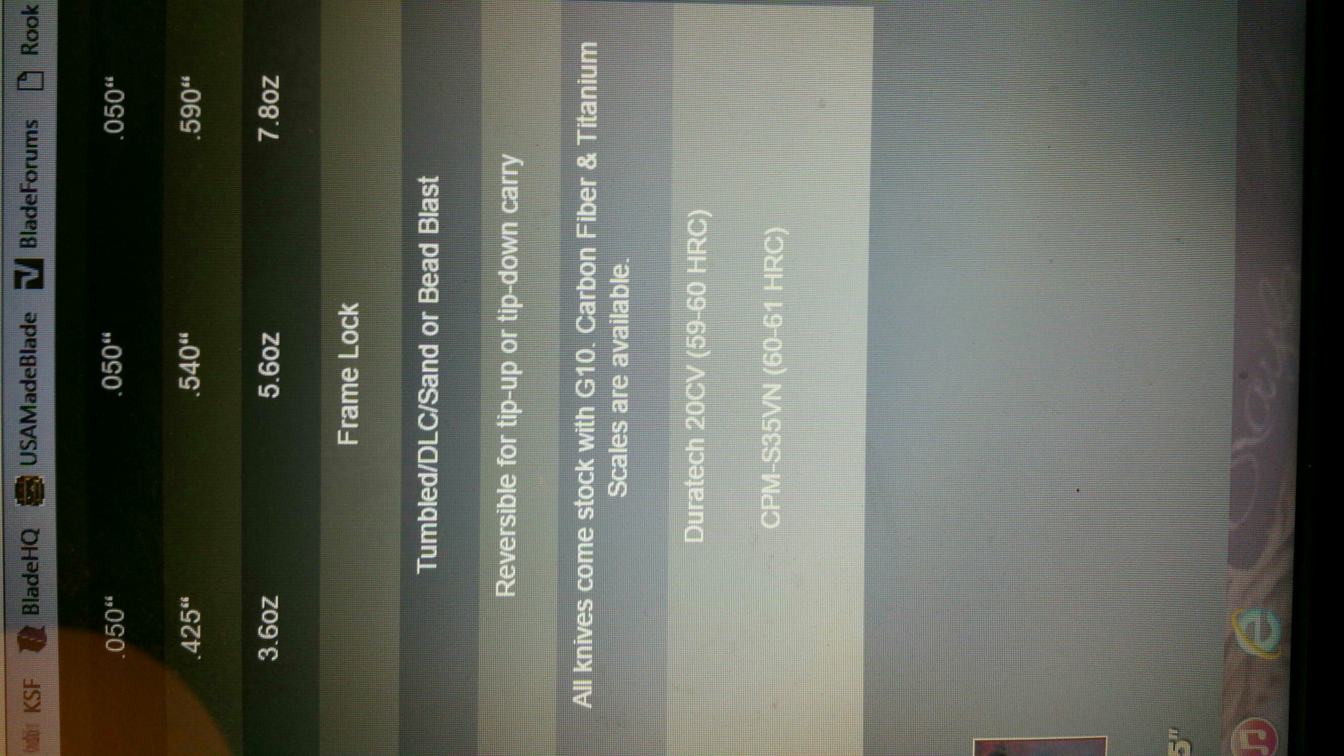

That's what all the hinderer stainless steels are run at, 60-61. This is from the blade HQ website description for a 3.5" XM with CPM20cv but that's basically the same steel as M390. DLT doesn't list the exact hardness for the M390 but it's a safe bet it's around 60rc.
Well this was taken from his website so I'm sure there is some miscommunication somewhere.
They are both around 60. You do realize blades are heat treated in batches and 2 blades from the same exact batch could be 2 points different? Depends on where they sat in the oven and other variables. Regardless they are all in the same range and I doubt anyone could tell the difference in practical use of M390 at 60 on one XM and 61 on another.
I completely agree, was just curious why a dealer would have something other than Rick's own website. Just curiosity, but back to telling a difference between 1rc.. I don't think CRK would've gone from 58-59 to 59-60 if there wasn't a noticeable difference. To most people, they wouldn't/couldn't notice but to someone who sharpens or does the actual testing of the steels could (not me) though I have been able to tell between certain steels in a little different circumstances.
