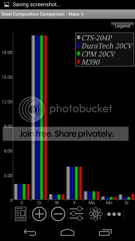

M390 is made by Bohler Uddeholm and is based out of Austria.
There are two American M390 equivalents.
One is CPM 20CV made by Crucible.
The other is CTS 204P made by Carpenter.
My thought is that they might want to support an American Steel Producer.
Benchmade just released a Grip in 20CV at BladeHQ, and Knifeworks has stocked some exclusive 20CV 940's
M390, CTS204P, and CPM 20CV are my favorite steels (as a whole) and will not preform any different from each other. They IMHO are the kings of stainless:D
