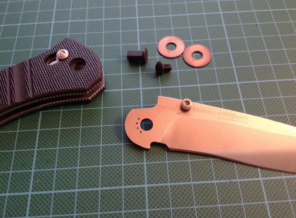

Don't think it's to identify blade steel. Compare the different "hole" pattern on the OP's knife and on one of mine...
I don't know. Should I disassemble some other M4 BMs and mini grips just because of my curiosity? I've never seen such holes on a BM blade and I got more than I can count right now.
Hmm...I guess I've got no idea then. I just know I have 2 knives with the holes, and both are limited editions, one in m4 and one in m390.
Edit: after inspecting both photos again I noticed that while the hole pattern might not exactly match, the number of holes is the same. Meaning the number of holes is the indicator, whatever that indicator might be for. My best guess is still that it designates a particular version of a model. For example, the standard blades would feature no holes, because they wouldn't need them being standard models, then each different variant or blade steel would feature a different number of holes. It would be interesting to see if other knives that are available in a variety of blade steels also feature these holes on the variant models.

Neither am I worried. Looks like the coating got burnt during grinding/sharpening.
The holes are a mystery though. They are quite rough and irregular. Could be what mkjellgren pointed out, but I would imagine BM had the means to put a nicer marking on the blade.
Furthermore, the holes come in contact with the washers. Sebenza comes to mind. Maybe pockets to "store" grease or oil?
The holes are rough, however, and I could imagine them creating some friction, but my knife is extremely smooth, especially after applying a teflon-based, fluorinated grease.
The hole pattern just looks so messy, I can't think of a machine or process creating it on purpose.

Then they've been "experimenting" for a couple of years. 154CM bladed Presidios have no extra hole in the blade. M4 Presidio made in 2011 on the other hand... 154CM blade Griptilian has no extra holes in the blade. M4 blade does... Does the D2, s30v and N680? If they do have holes, how many on each different steel? If someone was brave enough to disassemble a mini-Barrage and a Cabela's mini-Barrage with D2, I wonder if we would find a hole or two in the D2 blade.
My money is still on a designation of which steel. Satin finished D2, s30v, 154CM, and N680 all look pretty much the same. The hole will tell employees what steel it is before being lasermarked. Using a laser or plasma cutter would account for a hole or two not being perfectly cut through (little bit of slag left in it).

No, he does not work with plasma and laser cutters, so we forgot to consider that.
I think you solved the mystery. I can (only) imagine that a laser or plasma cutter would leave such a "messy" pattern.
I am brave enough, so now I have to check other LE BMs to see if they got the holes and if so, how many...

BM 710-1 KW exclusive, M390 steel... 4 relatively clean holes!
