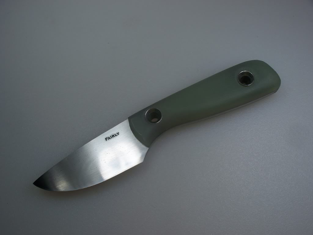

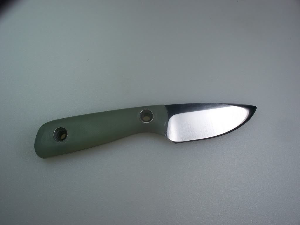

M4 steel and Jade G10!
It's not miniature but it is a smaller version of my Legal EDC model, I think it is a great size for every day carry.
This one is going to a Bladeforums member, thanks for the support!
This is M4 steel, the steel of competition choppers. I was floored by the wear resistance it had when I worked it, I have never used so many belts on a smaller knife! Super tough and super wear resistant, I am impressed.
6" long - 2.5" blade .103" thick

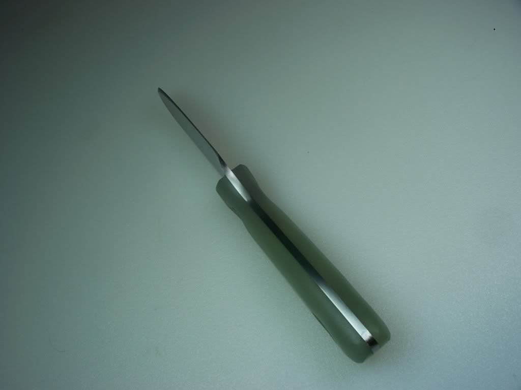

I'm not really too sure, I sell 'em all but I make a lot more chisel ground knives.
I have always specialized in chisel grinds as I prefer them for performance.
In my mind a plane is better than a wedge for most cutting, the non ground side has the most perfect cutting side geometry possible as well. I can go thinner and sharper and still have more strength at the ricasso with a chisel grind.
