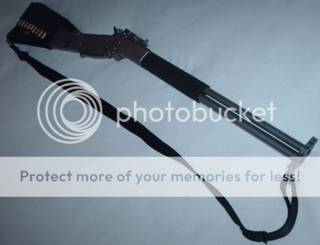

I've had my M6 for a couple years now and absolutely love it. I recommend removing the trigger guard as it allows it to pack down pretty small. Also, invest in another take down pin as it can be easily lost. A rifle buttstock shell holder fits on the buttstock and carries an extra 9 .410 rounds. If you get a M-16/AR 15 30 or 20 round magazine pouch, it will fit too and will hold a fire kit and extra box of .22lr rounds.
Here are a few pics showing its size. I'm 6' to give you an idea of the size and the length of pull. It's short but it isn't meant to be an all day range gun.
I really like the M6. On a winter trip a year ago, we were easily picking off .22lr 50 round empty boxes at 25 yards. It would be no problem using it for squirrel or rabbit or any small game at that distance. I'm upset these are getting hard to come by. I really love mine!

Can you tell me just how you removed the trigger guard? Did you cut it, punch out the pin, or spread the frame? How easy was the conversion?
Thanks
My gunsmith buddy carefully cut it with a dremel. The pin was stepped and not a simple push pin. They used to use straight pins which made removal much easier. 100% worth it!

gotta love those M6! i've had mine for about 6 years. .22 LR/.410, stainless. i made a complete survival system around it.
i took off the trigger guard, put a detatchable sling swivel in the buttstock, and made my own sling out of 1" tubular webbing. i took a dremel tool to the front sight and under cut it, then painted the rear peep sight and the undercut post site black so they would be clearer to see. i also bought a hammer extention from Cabellas, it works great for winter or when wearing gloves.
on the sling i have 3 knive pouches that make up some of my kit. one contains three winchester #000 5 pellet buckshot shells. another has a SAK , a mini-mag AAA flashlight and a scout mini firestarter. the last has a Silva match case with compass and a home made pivet pin for the gun.
Heres how i made the pin:
i shoot CCI mini-mag HP's through the .22 barrel with very pleasing results. i can also shoot CCI shorts for stealth hunting. the .410 works well with winchester 3" 7 1/2 size shot and i get good paterns with winnie 3 & 5 pellet000 buck shot for possible defense or hunting smaller big game. i have hunted both squirrel and rabbit with both barrels successfully.
on/in the nylon case for it i carry several Uncle Mikes magnum rifle shell holders and fill them with the shotgun shells. i carry a MOLLIE mag pouch with two, 100 rnd boxes of .22 shells, one the mini-mags and one shorts. i also carry some home made snares, fishing kit with yo-yo fishing reels. the case also contains either a CRK&T M-16 4" tanto blade or a Cold Steel ODA knife.
i bought it at Sprotsmans WH at the time for $200, now i wouldnt sell it for any price! i too found Jimbo/VShrake's website and took ideas from him on how to improve the gun. i did try wrapping the barrels with paracord but it warped them and caused it to shoot badly. i do not encourage anyone to try doing that, you can always carry extra cordage on your person.
