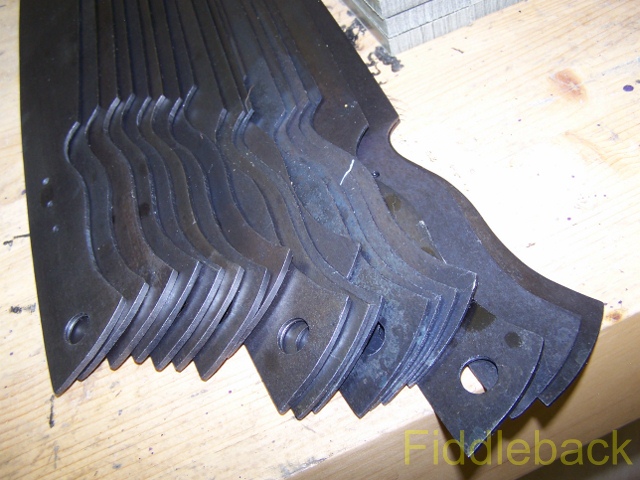

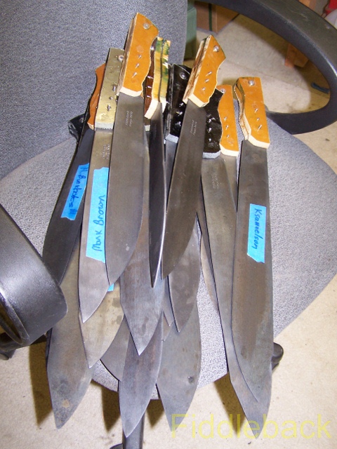

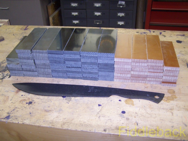

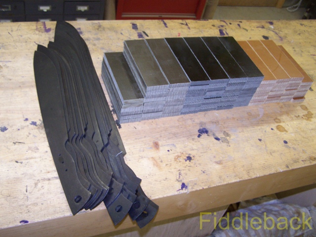

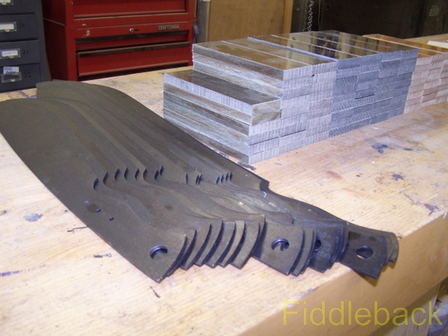

Here are a few WIP pictures of the machete batch last week if y'all are interested.
Just cut up the micarta.
Blades cleaned. They come all gooped with oil.
Those look amazing.
Specs? (besides what's on your website?). 1075 carbon steel? blade thickness and weight? Are the micarta scales removable? I think it'd be great to get one and buy a "backup" ready to go blade blank to replace it when you wear the first one out.

1075 steel. The 12"er is 3mm steel tapered from butt to tip, the rest are 2.2mm steel again tapered from butt to tip. The scales are not removable. Neato idea, but these are made in El Salvador, and the holes aren't computer made, so there is variation. It wouldn't work. Plus, the scales are made by me sculpted individually by hand with files. So you can't get another set anywhere. Good questions!
