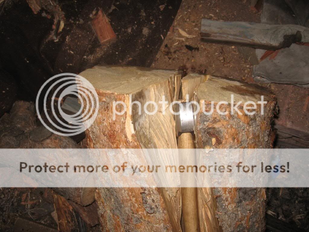

Big logs are no problem for a hatchet.
Turn log once hatchet is buried
Repeat and pow.

This is a fatwood log. The hatchet head was ringing, when I struck the log, like I was hitting metal. This log would eat a machete.
I was hitting so hard I broke the bit loose and needed to rehandle the hatchet after that.
