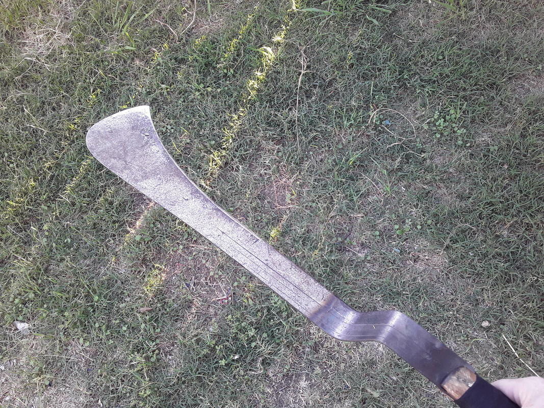

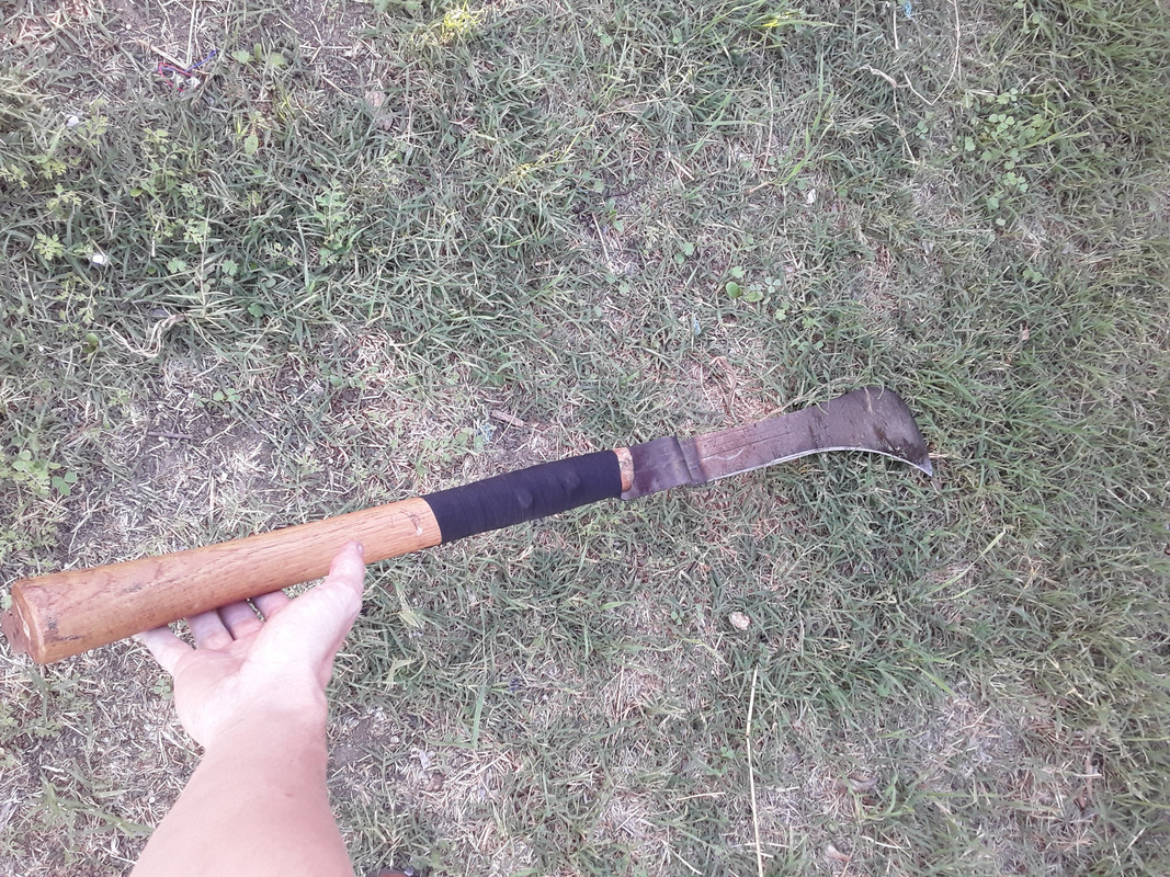

I guarantee you've never seen anything like this before.
I believe I bought 3 different gavilan machete assortments from Sportsman's guide maybe it was just 2, but I wasn't afraid to modify any of them that I didn't just outright give away.
This was no exception, a bill hook machete that I used quite a lot.
Recently I had some work to accomplish so I modified it to get that work done and it worked so well I've continued to use it.
Gave it a compound bend ( I'm not concerned about ruining the temper in part of it ), and attached it to a piece of broken axe handle.
