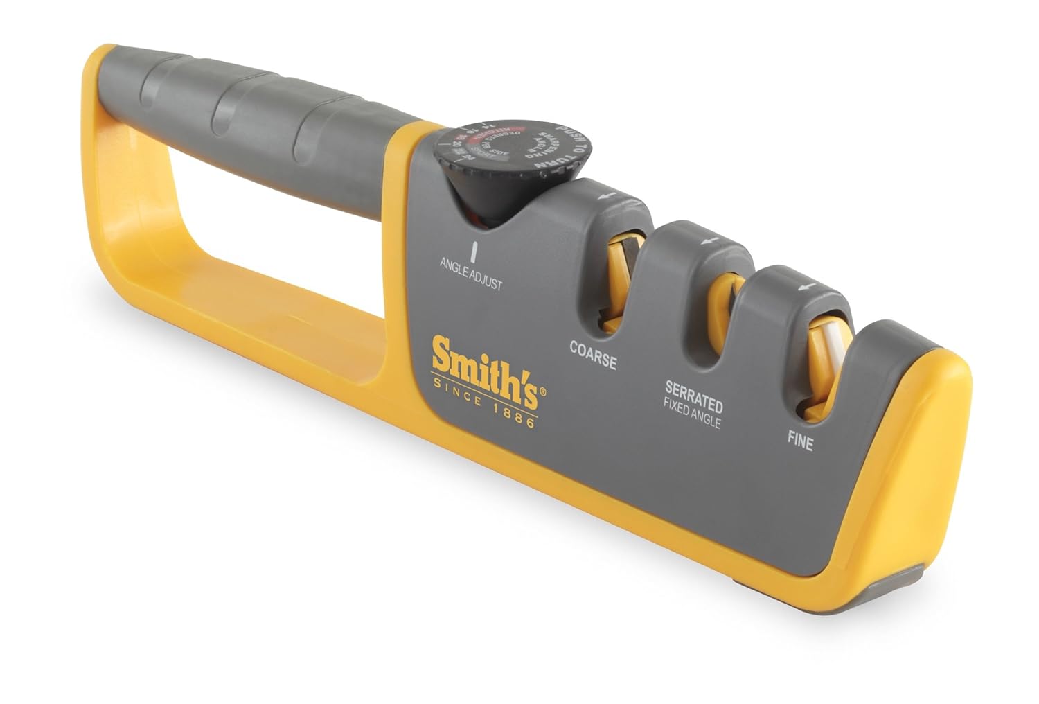

http://www.amazon.com/Smiths-50264-Adjustable-Manual-Sharpener/dp/B007Y15LD4
Either a file or this. I never use it to actually "sharpen", but it's excellent for restoring a damaged edge very quickly or reprofiling. I often use it to make an 8 hour knife reprofiling job an 8 minute job. It's so wide of a slot it can even accommodate a 1/4" inch blade thickness. You can then finish the edge with finer stones/files. google India and arkansas files for edge maintenance.
