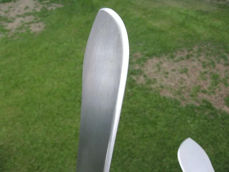

Just finished putting an edge on the Tramontina. Cleaned up the factory edge with a small file then took some sandpaper and finished it out. Don't think I will put it on a stone for now don't need it shaving sharp. Also rounded the top of the blade some so it won't tear up my hands. Headed to Garden of the Gods all next week to try her out. Thanks guys for all the advice :D

IMO edge geometry makes a big difference in performance. If you have access to a belt sander then that is by far the easiest way to go. You can do a good bit of the rough work of convexing the edge with a file, as shown in the video, then finish off with sandpaper over a mouse pad. That is the method I use.
You can get a working edge with just a mill file. In the field I use a diamond rod for touch ups daily but also carry a small mill file for edge damage.
In the short run a file sharp machete seems to be working just fine. If you switch to one that has been properly convexed you notice the difference. The same goes for a blade with a full convex. You can can do all sorts of close detailed cutting with a sharp convex at the base of the blade. If you switch to a blade with a sharp scandi at the base your work gets easier. It's not a huge difference but enough to make a difference IMO and that's why I take the time to do this to machete's I'm going to use. Mac
