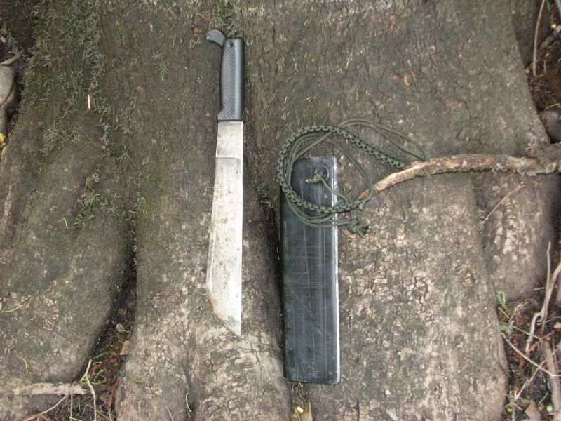

I made the sheathes for my machetes out of thin-wall PVC drain pipe which I heated, flattened, and shaped. Made belt loop with same material. Afterwards I painted it with gray spray vinyl paint. Lastly I wrapped sheath with paracord. Worked out beautifully in the jungles of Hawai'i. ;)

I also used plastic pipe to make a sheath. Carry it cross draw or slung over the shoulder with a baldric rig. The sheath makes a decent cutting board in camp too.
I like the PVC sheaths, never done one, but I wanna try.

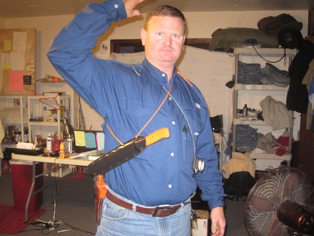

I like that style of carry, do you have any close up pictures of that rig?
Good pictures too.

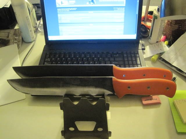

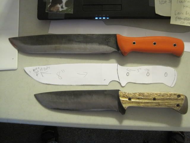

Thanks. I guess the real question is, what you got there? Is it your design?
-RB
Yea that is a deisign I made up a couple of week ago. I am going to make a smaller one in the next few weeks. the big one there has a 10 blade. the next one will have a 8".
I liked that design so much I made up another 10".
One for each hand.
