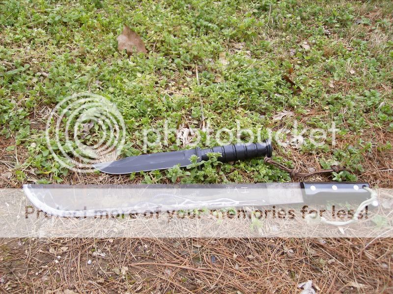

I've had good luck with my cheap Cold Steel bolo. I like the bolo, with that bellied end. That end helps chopping up stuff around the yard and garden when you need short strokes.
The problem with the CS machetes are the handles are kinda bulky. I have large hands so it doesn't bother me too much.
Personally, for light vegetation, I actually like the Gerber Gator machete. Anything heavier, and I really like the Gerber Brush Thinner billhook and the Cold Steel Spearpoint machete.
