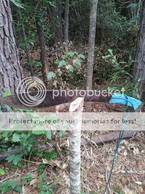

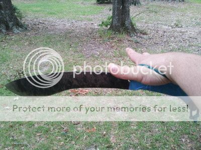

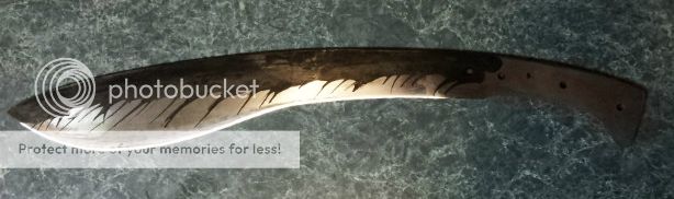

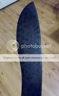

I have several machetes but have started forging them trying to find the perfect one for me.I have forge two thus far. They chop well but still adjusting the drop. Both have a distal taper and tapered tangs, steep flat grind infront of the riccaso and convex starting 3" past riccaso. About to start on another one and will take more drop out adjust the nose and change the convex taper on the nose as well. Hope to get it right this time cause my arm is about to give out swinging the hammer! Here are a few pics of the first two. They are both 1.52 and 1.65 lbs total weight 22L
The first one
The second one. Changed the nose and convex height. Still too much drop IMO I do like the cold blue on this one.
