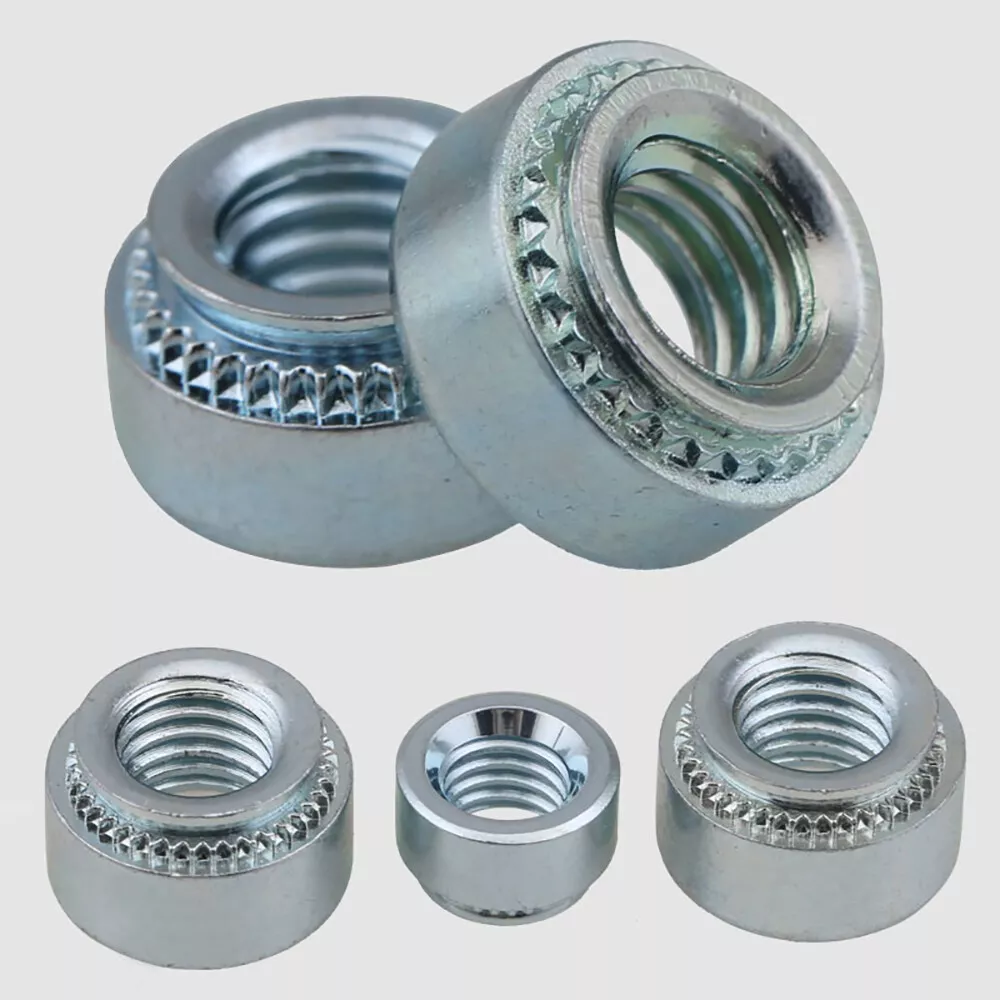

Rather than rivets I suggest using machine screws and self-clinching fasteners. Makes for a very attractive round nut that's available off-the-shelf at a lot of brick and mortar locations (like Fastenal) and super easy to find online. Ideally, use a counterbore for setting them, but they work fine in normal holes too.
I just did a search and lots of different items came up. Do you have a particular model or picture that you could refer me to?
I’ve been wondering if I should recycle the old pins or get something else…
These little guys. The integral serrated washer keeps them from spinning once inserted, especially if you stick 'em in a counterbored hole so they get good flat contact at the bottom. But, like I said, they work in standard drilled holes, too. Counterbores are pretty cheap if you know how to google, and it's not too hard to find interchangeable pilot ones so you can get the right match of hole and counterbore.
