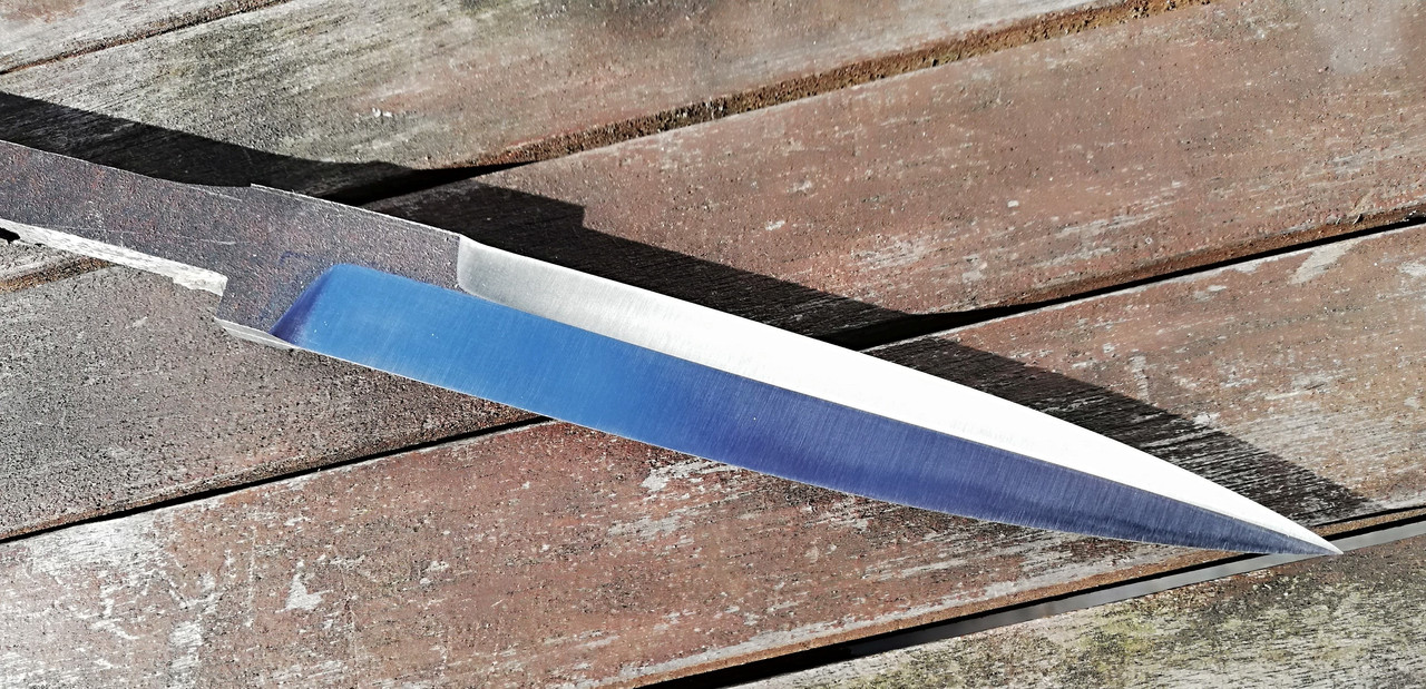

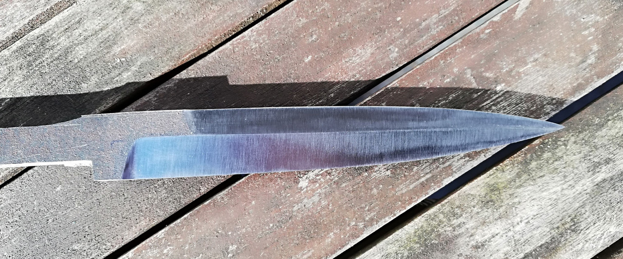

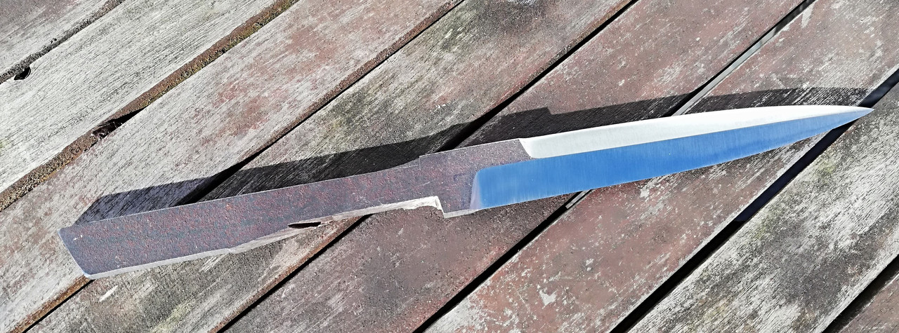

I practised some free hand hollow grinding on an old blank that was subpar.
Now I'm actualy quite happy with the result, and I may even get it HT'ed.
This is grit 240.
If you do a machine finish to what grit size do you take it?

180-220 followed by either a medium scotchbrite or a cork belt loaded with some cutting compound works great for a belt satin finish. A scotchbrite will wash out lines a bit but I’ve found that to be less of an issue with hollow grinds than other types of grinds, cork won’t wash out as much, other structures abrasive belts work well also. Trizact/compact grain belts/norax id suggest trying a bunch and see what you like best. My belt progression currently is 36-50 in ceramic (I like the vsm 880 and vsm actirox) 120 in either the same ceramic or zirconium belt (been trying the zirconium belts recently cause they are cheap and cut sharp so the cost balances out with a ceramic but is a bit faster and you change belts sooner) from there my favorite pre polish belt is felt backed aluminum oxide belts like the Deerfos line, I use a 180 in that belt then go to my scotchbrite if doing a satin finish. For higher grit finishes I’ll either go up in the deer belts to 320-600 then hand sand or trizacts in that range. I really only go up higher in belts if I want to hand sand. I’ve also seen some phenomenal finishes just going up to 1200 in the deer belt then buffed with black compound and skipping all hand sanding.

220 grit on hard wear resistant steel, sometimes red or blue Scotchbrite after.
On other steels 400 grit. I can see no reason to go higher than that on a knife that actually will see use.

For a machine satin finish, I go up to A30 belts, Trizact Gators or Norax, or a 320 Compact Grain AO belt or something similar and then go to ScotchBrite or Cork belt loaded with compound.
