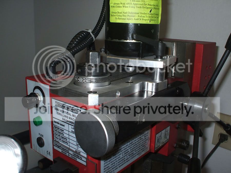

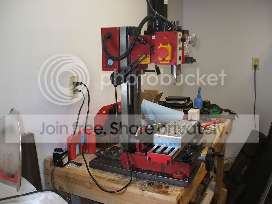

I scored a small Mini Mill off Craigslist ( HF 44991 ) recently for $250 and it had hardly been used. Not a bad little machine , but certainly has it's limitations , but being as it takes R-8 tooling , I was able to find tooling for it reasonably to get me going.
The machine is just part of the expense , the tooling , vise , clamps , etc adds up fast.
I have easily spent another $500 on end mills , dovetail cutters , keyless chuck with an R-8 arbor , 3" vise ,parallels , clamp kit , fly cutters , boring head , and recently a belt conversion made by a guy over on CNC Zone forum ( that gear head was LOUD ! ). Recently finished making the tooling plate ( from 1 1/2 thick MIC6 aluminum )...drilling and tapping 38 of those 3/8-16 holes was a pain ( next toy , tapping head ).
You can find plenty of info on various websites to teach you the basics. I have purchase accessories from Enco , Little Machine Shop , MSC and good ol e-bay.
One thing I found on the mini mills with the tilting column is they flex a good bit , modded mine by making a thick L bracket for the back , bolted to the column and bolted it and the machine to a 1" steel plate. Added quite a bit of rigidity to it. I won't need the tilt feature too often anyways.
So far I have just done some light machining with it , relieving some slip joint liners , making a work rest for my 9" disk grinder , etc.

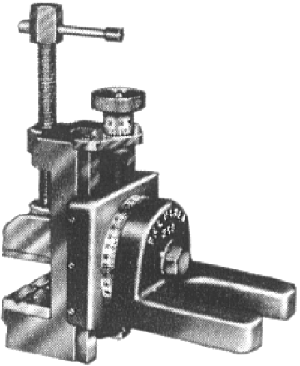

keyway's??? How would one go about that(endmill in chuck, stock clamped in toolpost?)??? I have a 12x36 gear head import lathe, But I bought it more for general fabrication/screwcutting/gunsmithing, but If I could slot gaurds that would be nice!
Would a milling attachment on a lathe be worth having??
I would have to agree with 12345678910, I'd have to pass on that one unless it is super cheap. To get that back to 100% might end up costing you more than it would be worth by a long way. Looking at the pictures there is no way I see that being a 40", maybe a 20" but it does not even look that big. I would bet you are going to have to replace almost every single bearing and who knows what else.
It might not be that bad, but looking at those pictures it looks like a money pit to me. If it was me I would save a little more money and buy something that that is not going to take a ton of work to get working, but it is up to you of course. If you do pick it up I hope it is not as bad as it looks.
John0270, you can (if you have a 4 jaw chuck) offset your work so you drill a hole that makes a keyway type hole but it would not be a true keyway because it would be round. Never used a milling attachment for a lathe so I cannot say how they are. If you have a drill press you can make keyways, build a small track that you can attach a small vise to, indicate it in and slot away. Later today I am posting a thread that will have a picture of track type piece that will show you the basic design.
