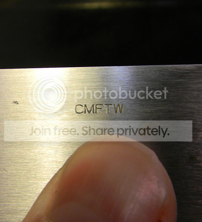

No, this isn't a service that I'll be offering. I don't usually make these but my favorite Paranoid Nutjob wanted a set and it looked like a good Sunday afternoon project for me.
...More than one beer was consumed during the construction of these stamps...
These are frequently made with little tapered cutters in graphite which are then used to burn the mark into the steel. It is a lot more dificult, from a machining point of view, to cut the mark standing out of the part like this than it is to engrave it into a trode and burn it (which is why I don't normally do this)
He wanted a very simple very small stamp, which is the one on the right. That is a tiny machined detail right there. I was worried it wouldn't read well so I made a larger twin just in case.
Large filthy machinist thumb included for scale...
The little guy marked just fine (I swear, my crappy eyes can't even see that thing while just holding it like that). I thought this was a cool project so I thought I'd share...

Thanks.
It's A2. It measured at HRC 58-59, which I thought would be a good hardness for something like this. I've made these before in W1 and O1 at that hardness but I think this might be the first time I've made stamps in A2.

Modeling, programming and machine setup took about 2 hours for the big one. Like you guessed, most of the trouble was getting the text right, there is nothing "turn key" in my CAD/CAM system. Machine time took about half an hour, mostly due to surface milling with a .030" ball mill on a machine who spindle is limited to 7,500 RPM.
The second part, the little guy, went much faster.
All told, from start to finish, it took about 2 1/2 - 3 beers (I did this on a Sunday, don't judge me :D) and consumed one micro cutter and put a little wear on an already used 3/8" endmill.
I put the parts into a batch going the Peter's, so I didn't fool around with the HT which is why the parts are so clean.

They are pretty stout. They're not designed to be use vertically like you'd use with a hammer or a vertical press. Narrow stamps when used this way are bad about getting wonky and pressing deeper on one side or the other. These are intended to be used horizontally in a mill vise which holds everything straight, level and square for easy, accurate and repeatable results. They're machined 90 deg square all around and need a pretty stout base in order to remain perpendicular to the vise jaw. This is probably a little different than you're accustomed but it is intentional. The actual stamp face with the lettering stands proud of the block a fair bit for visibility. It's hard to see this in the picture because you're looking at it headlong.
2 hopefully quick questions, first is there a way to make these stamps by hand? Secondly do you stamp them on the blade cold and with a hammer?
I suppose it would be possible to carve these out by hand with a little rotary bur, but it would require a lot of skill.
You press them into a blade cold before the blade is hardened. You could use a hammer but they usually give poor results. Most people do it vertical in a press. I have a press and I used to do it that way. I don't use stamps much anymore, but if I did I would do it in mill vise.
