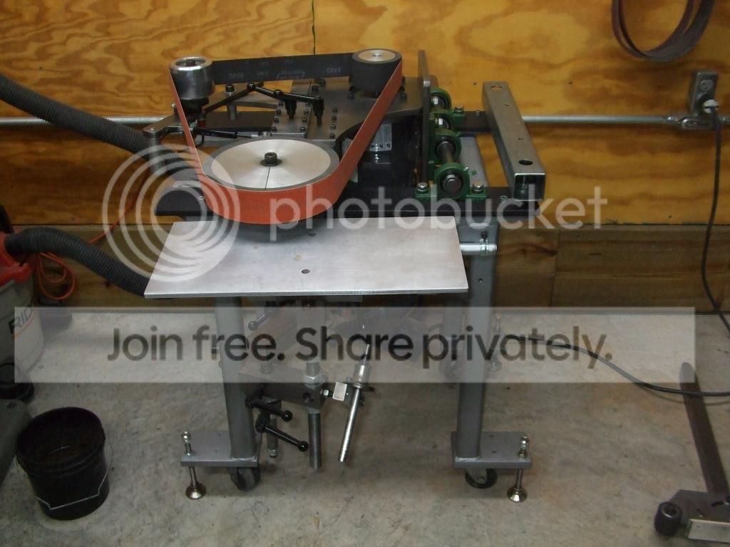

No more pressure and movement than it will get you dont even need a bushing. Here is the grinder I built.
And yes it goes horizontal too.
What do you use those little drill bits for?:eek: Seriously, what does the drill look like that uses those things??
Well done! I really like your rotation mechanism. looks solid. What RPM motor did you go with in your direct drive setup? Hoping to get started on building one soon.

I use a 1800 RPM motor and can drive it at 200% with the VFD with the 5 inch drive wheel its plenty fast for what I do.

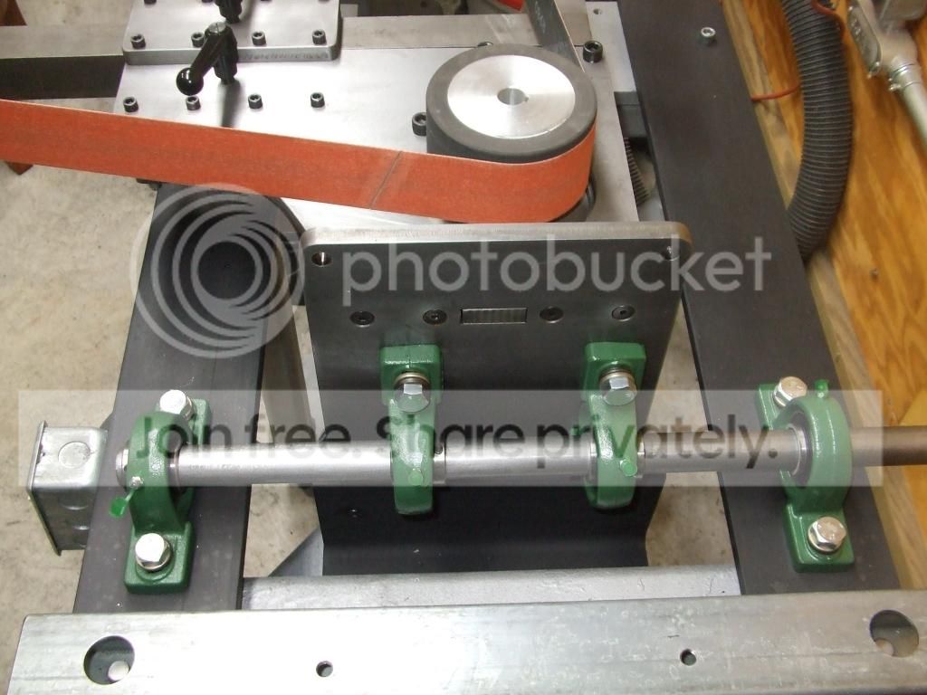

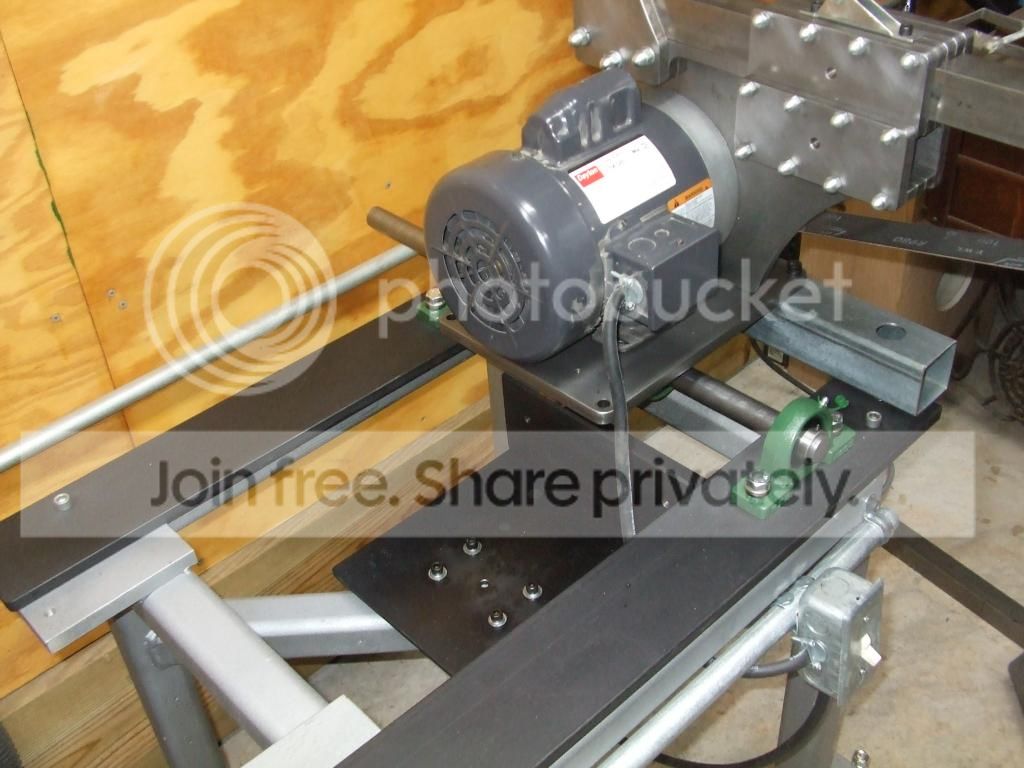

Here are a couple of pic's of how I setup mine to flip. Used 1"od rod and bearing bought them on Amazon.

Regarding your setup Plas62, Couldn't you have made the shaft fixed to the base with the two pillow blocks on the grinder?

Plas62, That is a really cool way to flip your GIB. What part of the grinder rests on the table to hold it level? Does the lower tool arm opening touch the frame of your table or is the motor supported by the pan you installed underneath? I know there has to be clearance to put a toolbar in the lower receptacle. Very nice build!
LarryZ10 - See pic #2. When the grinder is in the vertical position the base plate of the grinder rests against silver colored square tubing. When in the horizontal position the base plate rests against a vertical stop which is attached to the "pan". The tool bar holder does not contact the frame in the horizontal position.
I have tapped holes in both pieces that I run a bolt into, just finger tight to ensure the grinder does not flip on me when in use.
Johnathans - I probably could have attached the rod directly to the base and just used two bearings, but since I don't have a welder this was the simpliest way to do it. It also gave me a couple extra inches of height by using the bearings on the base of the grinder
I really like the use of the pillow locks as I can easily mount those to the bottom of the grinder, and they will perform really well. The shaft then can just be inserted through bored holes in the supports and secured with a good set screw.
