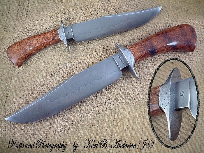

All three of these slotted with off-the-shelf 1/8" carbide end mills.
