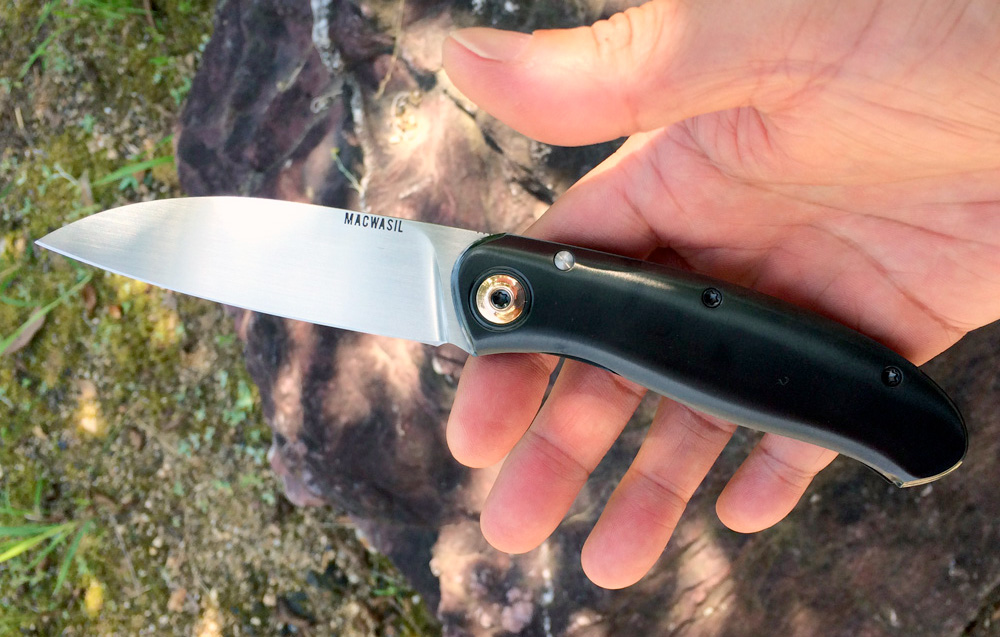

The fit and finish are really excellent. Nicely centered blade, great placement of the detent, and the separate scales which look like a single piece (he calls it semi-integral). Just perfect.
The blade is very thinly ground. Even though the stock thickness (3.3 mm in my measurement) is thicker than his previous versions (3~3.2 mm) and what I anticipated, the deep grind makes the blade a good slicer.
The DLC coating on the titanium handle is kinda unique. It is like having a thin black glass or porcelain on metal. I anticipated a mat black finish, which seems common in production knives, but this one is a lot better than what I imagined. I really like the brass pivot collar on the DLCed scales. The coating is done on satin-finished scales. I have to see how they perform in wet conditions. Válcav also put some additional touches on the scales, which give the knife grace. What an elegant gents folder!
The design is magical. The handle is very ergonomic to my medium hand. But the best thing is the blade shape. It seems versatile. The angle of the blade to the handle enables you to cut veggies on a cutting board comfortably with the almost straight edge.

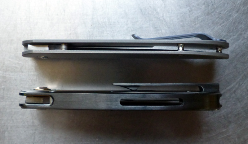

Inside view. It was a bit hard to disassemble it because of the very tight tolerance.

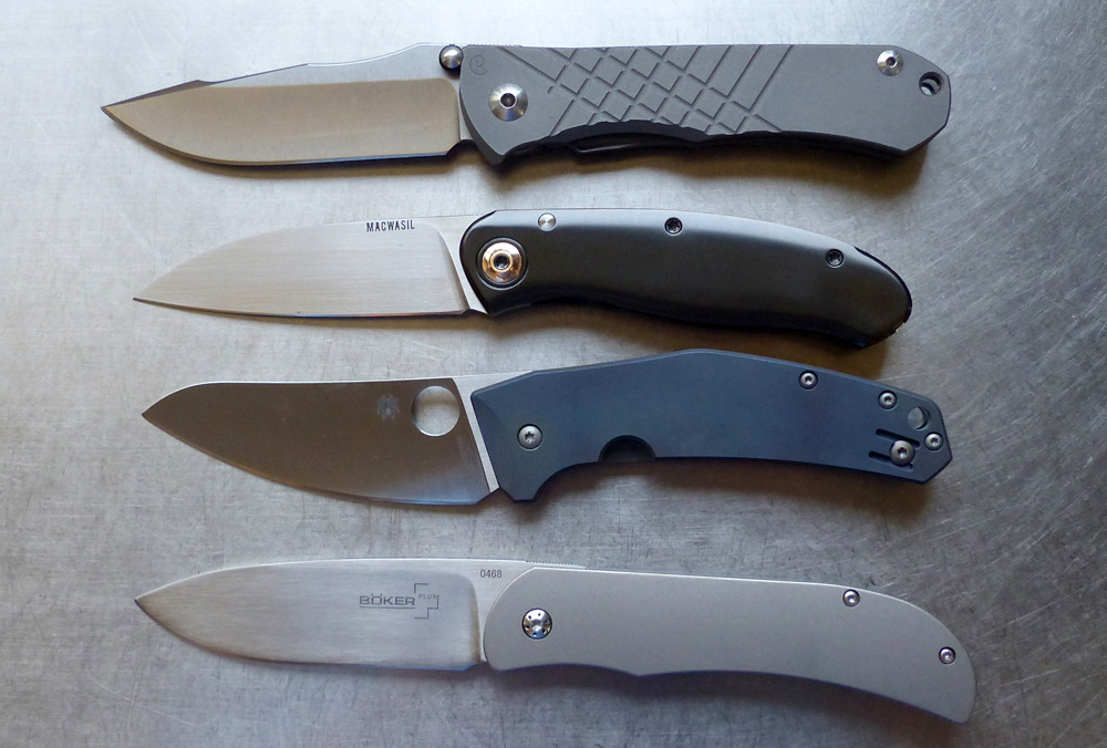

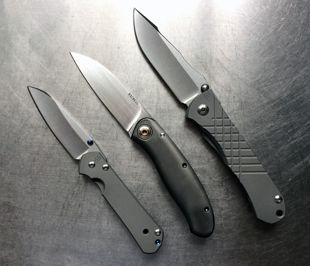

Comparison with other frame lock folders. You can see that the blade to handle ratio is big with MacWasil, which makes it a small-large knife like TiLock.

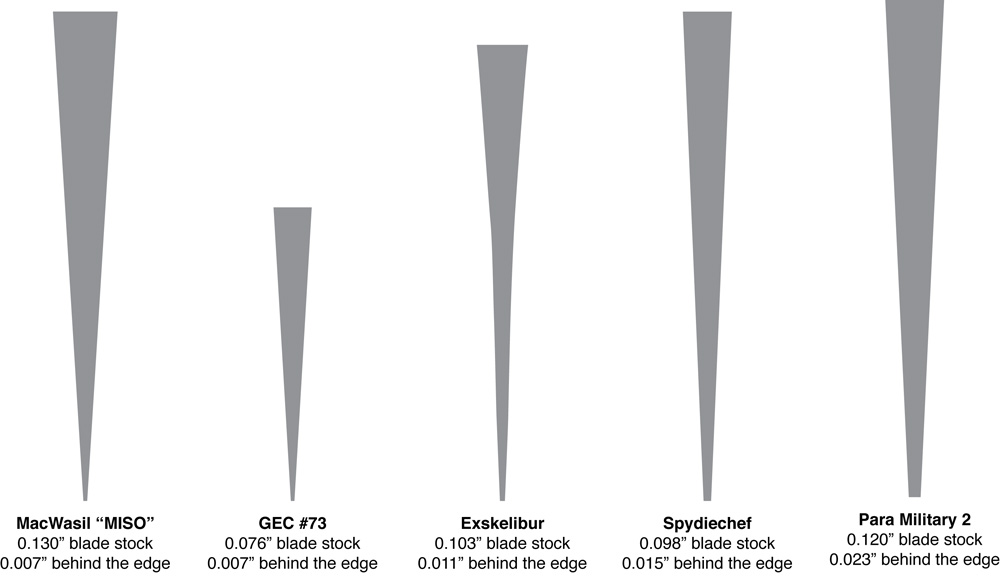

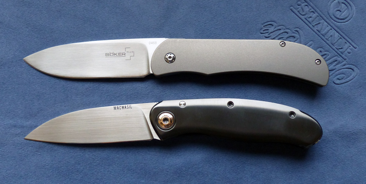

Here are some comparison to Exskelibur.
The edge line is just perfect for me. Uniform curve close to a straight line.
The blade is thicker, but the grind is very deep to leave a thin edge. In fact, the primary grind is almost identical to GEC #73. Of course, there is no flimsiness.
Thickness of the scale is quite similar between the two. The semi-integral design of MacWasil scales makes them quite sturdy, though. Fantastic.
