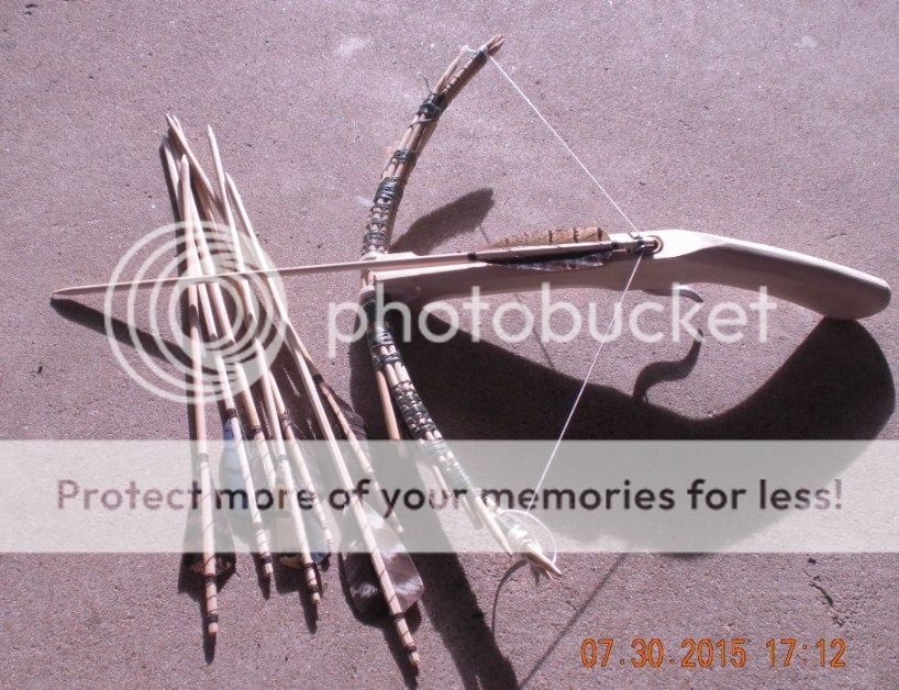

I used to make bundle bows out of bamboo like this as a kid, and put one together for my daughter a while back. Turns out she doesn't have the strength to really pull it back, so I made it into a crossbow for her (I still have to cock it). Nothing fancy here. It took real effort to restrain myself- I had to keep telling myself this was just a quick toy; not a masterpiece.
I'm posting this here to give ya'll ideas. This type of bow could take small game at close range, and takes a matter of minutes to make. Ya don't have to carefully carve the limbs, and instead use overlapping sticks to get the same effect as tillering. Just keep flexing it as ya wrap, and move the string up or down on individual sticks to get both sides to flex evenly. Naturally, you could scale it bigger for bigger critters. I'm sure a carved self bow is superior long term, since that's what historical peoples used, but a bundle bow may get ya by while you're carving it.
The crossbow mechanism is only 2 moving parts, with a piece of bent wire for a spring. The same design was used on some medieval war bows, so it can scale up to serious proportions just fine.
I usually strip feathers off the central rib, instead of cutting them down the center. I prefer turkey feathers (tail feathers for these small arrows, wing for full sized arrows), but ran out of 'em. Gotta sort through a whole pack of shishkabob sticks to find ones that are straight and sound. I used to make steel broadheads for 'em, and then they would fly completely through 2 layers of cardboard & work on small critters.
The points on these are sorta dull, until my daughter proves she's responsible enough with it. They will fly about 60 yards the way this one's set up; my older ones would go over a hundred.

That is really cool. Could you post some more pics of the trigger mechanism?

It looks like you used the not-straight bamboo skewers for the prod and the straight ones for the arrows? What did you bind it with?

Thanks for the compliments, fellas.
Bore-
I haven’t experimented with shorter arrows yet. The little bows like this I made in the past had a longer draw, so the arrows would be about the right length for those. I’m thinking about making another one, so I decided not to cut the arrows down yet so I can use ‘em for both bows. This is also why they have the long space between the fletchings and nocks- this gives room fer yer fingers when drawing ‘em on a small bow (that’s not a crossbow).
Trentu-
It’s kinda hard to see how it works, so I’m also adding a sketch. I’m making the sketch vague on purpose, so you can use your imagination.
Basically ya just need a round roller (called the "nut") with some hooks filed on top that hold the bowstring. (plus a groove filed down the middle to make room for the arrow nock). Then ya cut/file a sear notch on it, where the trigger sear prevents it from turning. When ya pull the trigger, it lets the nut rotate freely, so the hooks tip forward & let the string fly. The same idea could be easily modified for a sliding trigger or even using a rocker bar, so you could put the trigger about anywhere ya want. Mine was made from a bolt, strip of scrap iron, a .308 casing, brazing rod, and a strip of wire that came off my old windshield wipers. You might prefer a flat lock plate, a couple nails, and a rubber band, etc. I’ve seen several antique ones where the nut (the roller piece that holds back the string) was made of ivory, with a steel sear plate.
Nkt2-
Sure, the sticks for the bow don’t have to be too straight. If ya sort through a package of ‘em though, flex them a bit, and you’ll notice that some of them feel soft and spongy, and stay bent when ya flex ‘em. Save these for the barbecue grill. Some others will feel exceptionally strong and springy, and these are the ones to save for the bow. I do have a chronograph now, but never thought to measure their speed.
I used 60 pound Spyderwire for binding, since I had some layin’ around, but nearly any string will work so long as it’s strong and light, and not too stretchy. At first I used the Spyderwire for the bowstring as well, but it dang near cut into my fingers when drawing it, so I replaced it with some thicker string now. (250 pound braided Dyneema fishing line)
