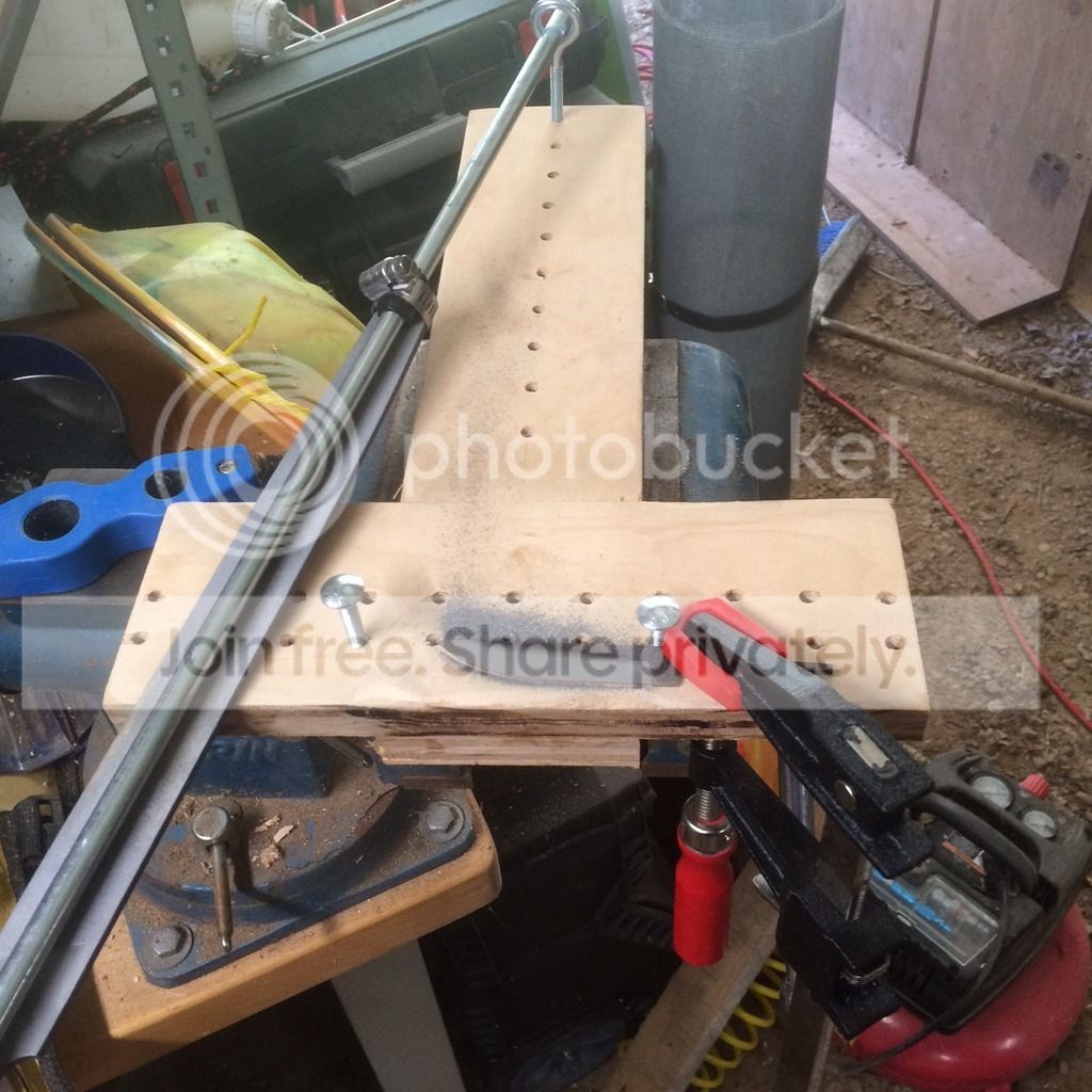

I use a jig to make my bevels. It is a "T" with holes drilled down the middle of both pieces one inch apart. See the picture below. As for centering, take a drill bit the same size as the width of your steel and use the tip of the bit to score a center line on the edge of the blade. If you lay the bit on the table, the point should be exactly half the thickness of the steel.
It is hard to see, but there is a set screw near the tip of the blade. All holes are tapped 1/4-20. I used a 12" file and a 30" steel rod.
The tools needed to construct the jig are:
- Hacksaw
- Ruler
- Pencil
- Electric drill
- Center punch
- 1/8" drill bit
- 7/32" drill bit
- Dremel, angle grinder, bench grinder or belt sander for preparing the file (needed once only)
Materials:
- 1x 11x3.5x0.75" Plywood
- 1x 14.5x3.5x0.75" Plywood
- 1x 10.5x3.5x0.75" Plywood
- 4x #8 Wood Screws
- 2x 1/4-20 Stove bolts, 1-1/2" long
- 1x 3/8" steel rod 36" long
- 1x 1/4" eye-bolt. 2-6" long (ideally get a couple of different lengths)
- 1x 12" Double cut bastard file
- 1x Roll of electrical tape
- 2x 1" diameter screw-type hose clamps
This filing jig can be used for filing full flat grinds, high flat grinds, and scandi grinds. It can also be used for doing convex grinds by doing a faceted grind and then blending the facets together.
I got the plans from Gough Customs on You Tube. It is a great jig.
