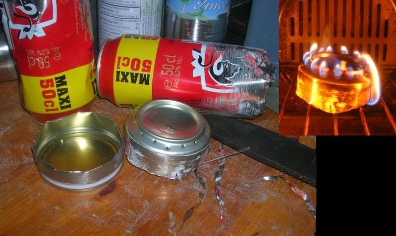

made my first beercan alcohol stove!!
nephildevil
BANNED
Apr 30, 2007
1,152
based on this youtube vid:
http://www.youtube.com/watch?v=GY_LKCFlG6k
as you can see i used completely different tools (there is actually a piece of sock inside mine :D)
and it still needs alot of work, that flame underneath might set the whole place or forest on fire
but it works!!
next attempt shud be better tho :p

I've messed around with them but haven't perfected it yet. I think I'll try a small drill bit next time as opposed to the push pin.
What kind of burn time did yours yeild?

yeah and i used that kinda thick rat-5 on purpose, i'm sure that made it more difficult than using the scalpel blade from the vid
but more realistic imo
its a survival knife, something like that is what i wud be carrying
an F1 is even more likely, but whatever

fitting those two halves together is where is had the most trouble
i suppose i'll have to perfect building the design i started on (since it is still such a clumsy first timer result :D), but i'm interested in making a more powerfull more presurized one with two chambers as described somewhere in the replies above.

looks like you'll need a lot of tools and specifically those heineken cans to make one of those
but i'd like to be good in building a minimalist can stove with just a knive (and maybe a nail or needle for the holes)
that way mimicking a survival situation where you wander around with ur knive and psk and find a few beer/soda cans and make something usefull out of them
One trick I have used to get a smooth cut on the aluminum cans is to fix the knife and spin the can against the edge, going slow and you can eventually make a perfect cut. It doesn't matter about the size or thickness of the blade, try placing the knife on a book at the height you want to cut the can and with the other hand spin the can on the edge, be patient and it will come out perfect. When putting the two sides together cut very small slits in the edge of the can that is being pressed into the base and remember to go slow.

I know what you mean. You could still do the holes with a pin, or nail. You could potentially use a normal soda or beer can for the bottom, but you'd need to crimp the burner better, and the simmer ring wouldn't fit as well. I should try making one w/out the Heineken can.
