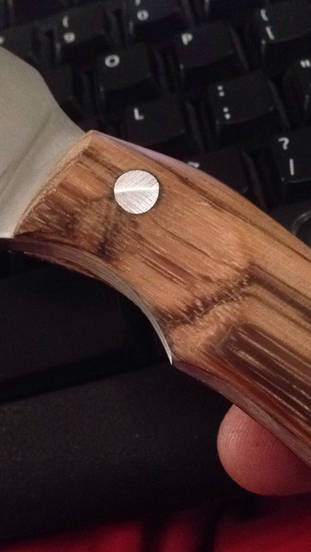

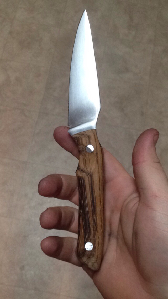

I decided to give the whole knife making thing a shot a while back. This is my first one and it took me probably about 20 hours over the span of 2 months. I think it came out pretty good for a first knife. I could do with some improvement on the plunge line and the top of the grips that get finished before epoxy arent perfectly even. But I know what I did wrong and will be working on it for my next one. I thought I could speed up the sanding process with an orbital sander and ended up rounding off the plunge line, but you live and learn.
3/16 O1 tool steel
1/4" corby fasteners (probably just going to use plain rod from now on.)
Zebrawood scales
And I made a kydex sheath for it with some OD green kydex and nickel rivets.
What do you guys think?
Ive polished up the pins and did a little more finishing work since the pics.
Looks pretty good! Only critique I have is to keep the pins flat. I wouldn't take that notch a the way to the pin. Looks great though!
That was actually on purpose. I had seen one done like that and liked it. Everyone has their own taste. Appreciate the input though.
Beautiful work! For a first knife, I am very impressed! Keep it up. Maybe some mosaic pins for your next? You also may want to put a finish sanding on that handle and give it a coat of an oil or poly or Sno-Seal the handle. Try Flitz metal polish....

Ive been looking for an easy way to polish it up. That sounds like a pretty good idea. I was considering coating it since O1 isn't that corrosion resistant. But I decided to just polish it up, or maybe let it patina.
And I need to go find some tung oil for the handle.
My grandfather wanted to buy this one from me, and he offered me a really good price, but Im going to just make him one for christmas, so I need to get started on that. I plan on using some mosaic pins and Im going to attempt making a knife with some brass bolsters.
