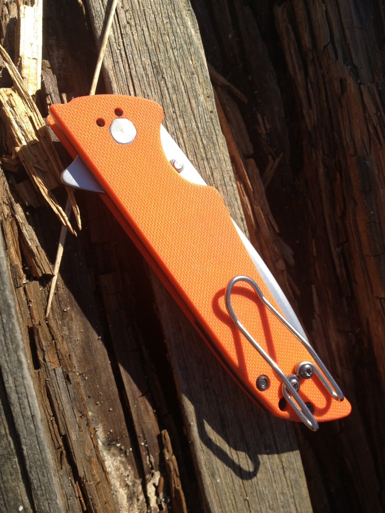

Made my own Deep carry pocket clip for my Skyline
I went back to the wire clip design. Decided to make my own wire pocket clip. I found that the Spyderco one I was using from the Pingo didn't mimic the same design aesthetics of the Skyline. This one is much more angular than the rigid square design of the Spyderco clip.
The strength is a little bit stronger on mine and there are no notch marks from the bending process. It’s made of stainless steel as well.

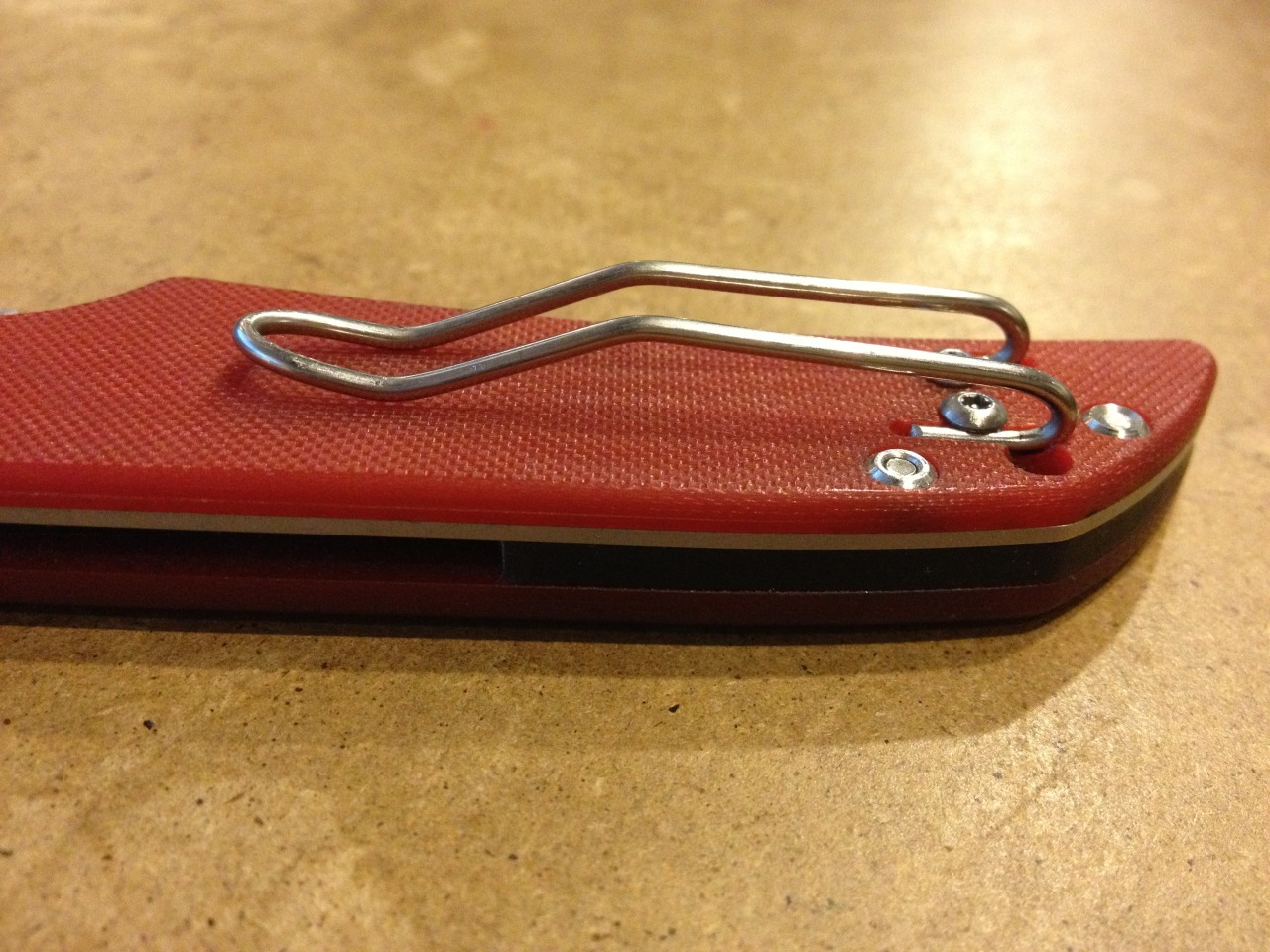

That looks really good! I already emailed you back, but I have two suggestions for ya. The first one I already wrote you about flattening the part where the clip attaches to the handle instead of making a groove in the handle. The second would be to have the clip come up a bit higher before bending down so it will ride lower in the pocket. Keep up the great work!
*edit*. I just thought of another way to have it attach to the knife. Instead of having the metal go straight down under the screws and hang off one side of each, why not have it loop back under the screw in a crescent shape? Sorta like how a washer goes under a screw, but doesn't go all the way around...
Thanks Chris! I got your email :) Your idea to have it loop around is great! I'll try that tonight if I have time :)
I am glad you like the idea! If you want an easy way to form the loops, start off with extra length for each one first , grab the spot you want to start the loop with some round nose pliers and pull the end around the pliers. Figure about where on your pliers the diameter of the screw is and do both sides with that spot to save some work. Cut the extra material off where the half circle is made and voila! It's how we form heavy tinned wired before we attach them to posts at my work. Where are you getting your wire?

I took Chris's advice and wrapped the ends so the mounting screws had more purchase.

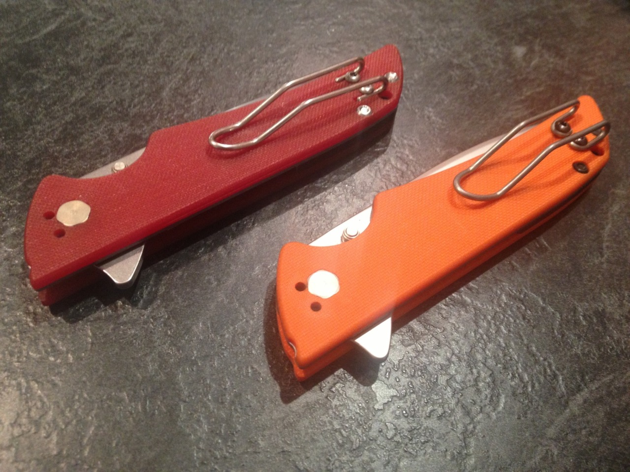

This is what I quickly came up with. I'll cut down the ends so they terminate closer to the screws.
Once I get this just right, I'll be acid etching and stonewashing the clips for a nicer worn look. Maybe I'll try them in black as well :)

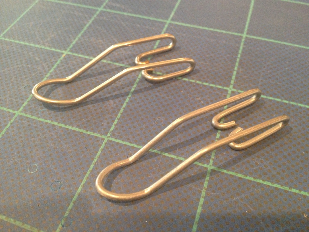

Oh @Rival1314 all I am using is a pair of pliers, a torch and a bench vise. I just measure and bend slowly & carefully.
What is the thickness of the wire that is used for pocket clips? Does the bending process require heat to work or just lots of strength? Looking good!

@annasoH323, the wire thickness is 1.8mm

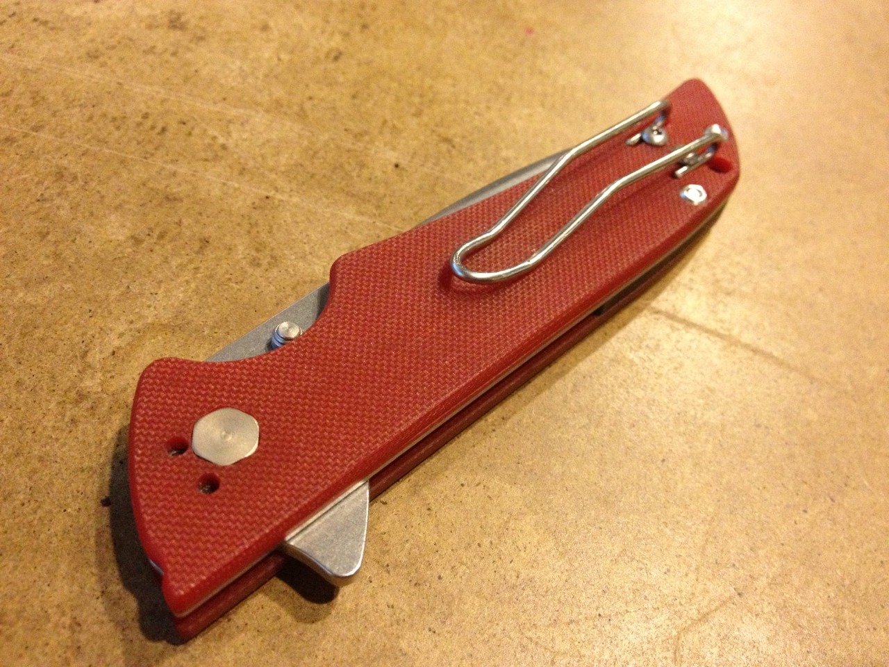

Some more recent shots. Here's from start to finish of the non routered design. This is a direct bolt-on:
And a shot of it installed and in the sun at the docks :)

What would have happened if you quenched the original rather than annealing it as you did? I'd try just heating it with a torch and tossing it in water. Should make it brittle (spring like). Who knows how tough? Might be worth a try as it looks quite nice. The heating might give it an interesting look as well.
Not sure what annealing is. I just mark the areas where I will be bending, heat it with a torch and then bend it with pliers to the shape I want. Should I heat the whole thing and then dip into cold water? Any advice would be greatly appreciated :)

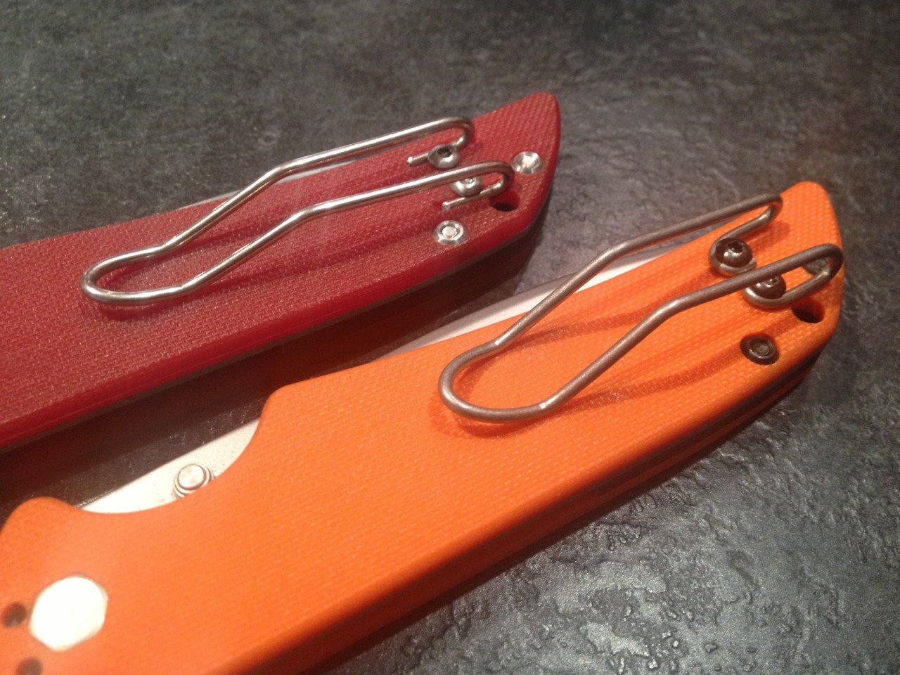

Here are the results after 20 minutes of stonewashing. I didn't use the PCB etchant like I thought I would. This way, the blade and clip match better. If I do etch it, I would etch the blade and stonewash it as well. But alas, no time these days :(
Pardon the photos as they are taken with my phone. The stonewash is actually much more pronounced. It closely matched the stonewash blade of the red Skyline :)
I have left the non stonewashed clip on the red Skyline for comparison:
