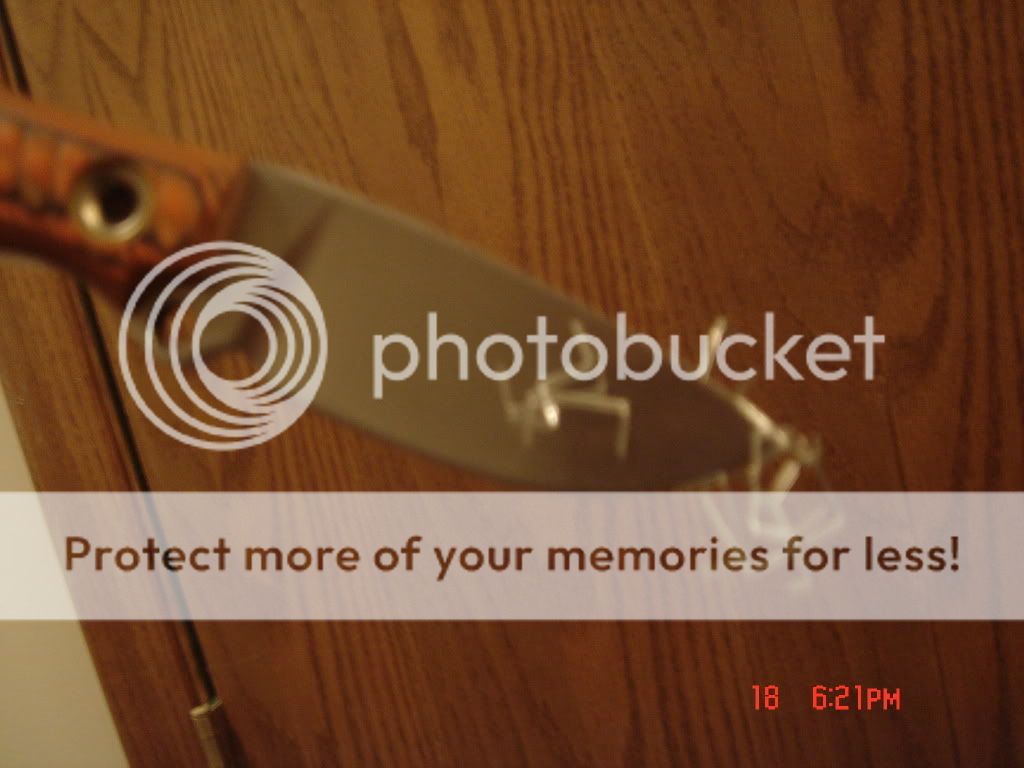

OK, So I'm at work right now and my .22 GW was in my desk without it's sheath. I go and pull it out of the drawer to use it and there were 3 staples stuck to the satin blade. I then took out a small allen wrench, set it on the table in front of me, hoverd the GW about 1/4 inch above it and the allen wrench lifts up and partially sticks to to blade like a weak magnent.. I know some steels have slight magnetic properties but I had no idea infi was one of them. Any of you folks experience the same thing. I am assuming coated blade won't have this affect because of the thick crinkle. I have never had any other blade do this to me.. Anyone have insight on this?

I would say the field should fade with time. If you have one of those old tape erasers, you may be able to demag it pretty quick if it's a problem. No telling what phase of the manufacturing process imparted a mag field on it. Could be from a mag particle inspection somewhere down the line.
Just my .02
All steel is magnetic, but not all steel is magnetized, as your knife seems to be. The magic of iron!
My GW and AD are that way too, I noticed when I placed a beer cap on it and when i went to use the knife it was stuck, and the AD has a stronger field.
I think Garth hammered on it right after its heat treatment to align the domains. Such the jokester. ;)
magnafluxing will do this, your knife may have accidentally been magnafluxed with the special batch that was done a while a go :thumbup:

Magnafluxing, developed originally by Carl E. Betz, is a method of testing ferrous metals for surface and subsurface flaws. The component being tested must be made of a ferromagnetic material such as iron, nickel or cobalt, or some of their alloys. This test is often used on industrial tools, and engine parts during maintenance inspections. It can also be used to diagnose failure, as in crash investigations.
It works by applying a magnetic field to the component under test, using e.g. a permanent magnet. This will cause a high concentration of magnetic flux at surface cracks, which can be made visible by dusting iron powder or a similar magnetic material over the component.
Parts can be tested using one of two methods. The wet method consist of bathing the parts in a solution containing iron oxide particles. The wetted part is then placed in a magnetic field and inspected using a black light (ultraviolet light). The iron oxide particles are attracted to surface discontinuities or cracks, where the magnetic field is discontinuous. The particles flux around the imperfections and the patterns are visible under the black light.
The dry method is based on the same principle. Parts are dusted with iron oxide particles and charged using a yoke. The particles are attracted to the discontinuities and are visible by black light.
It was common enough from 1999 to 2002 for new Busse knives to be magnetic.

I have this magnetic experienced this with some custom made knives. The reason for it in my case, was simply because the maker used a flat grinder with a magnetic table- keeping the knife blank in place.
