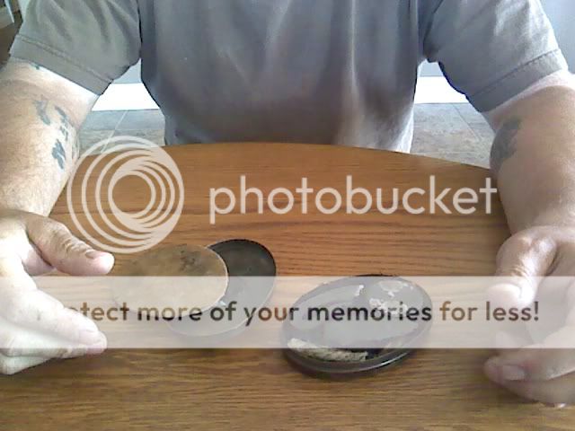

She says there is some leather in the pouch that she was not sure of it's use. Since I can't see it I'm not sure either.
That piece of leather is cut to the shape of the lid. It protects the lens from scratches and reduces any rattles. I also use it to hold the flint while pressure flaking (knapping) it back to a good edge. (Those flint flakes are really sharp!) There are a bunch of other uses for it, if you get creative!
Rick
You can see a bit of it in this pic...
Thank you so much everyone! You have solved the mystery and now I can practice to get skillful and impress Protourist. I plan to light the hibachi with the kit, and I will try to take pics and send them along to you. Thanks again!!

Without an actual fire... since I'm in my kitchen... lol (I'll post a video of the whole process, later) here is my method for traditional flint and steel fire lighting. I like this method because it uses minimum material, extending the life of my firekit supplies.
Here is the kit...

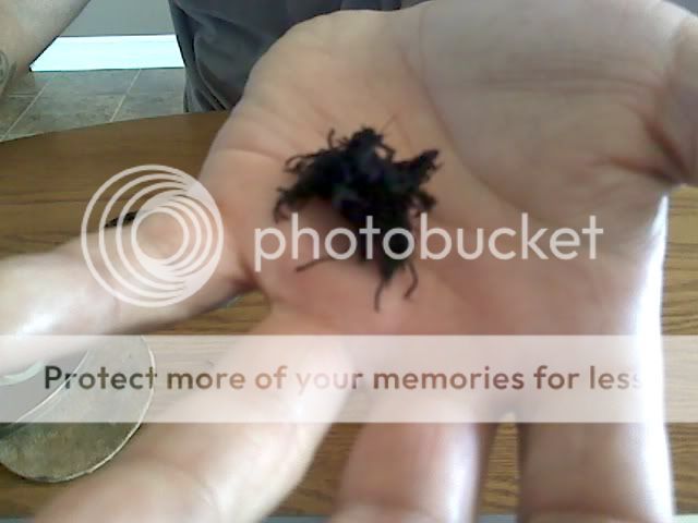

My char is made of shredded cotton. (terrycloth/towel) I find that the matrix of fibre really catches the sparks well...

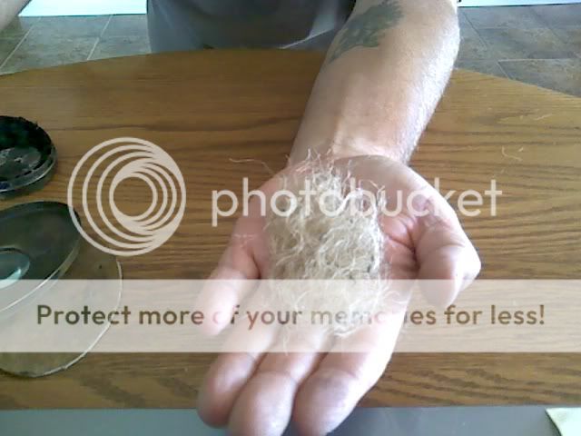

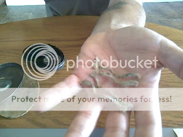

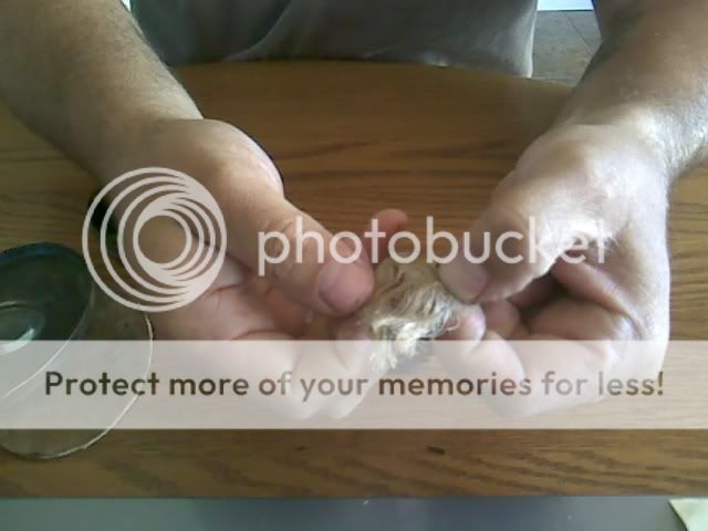

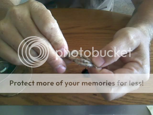

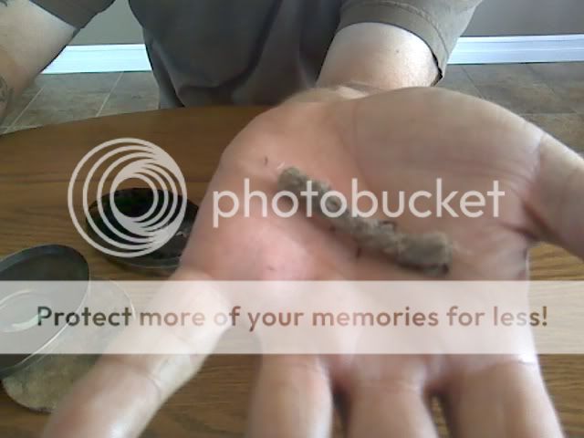

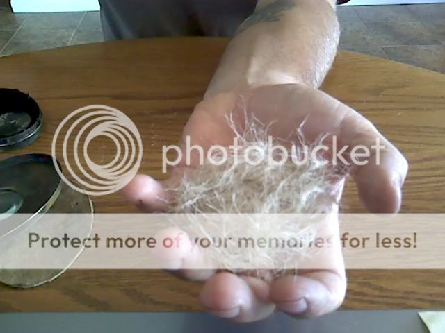

My jute is 4 strand reverse twist and is a little less than 2" long. I separate the strands then pull apart the fibres. I lightly compress the wad into a flat rectangle...
