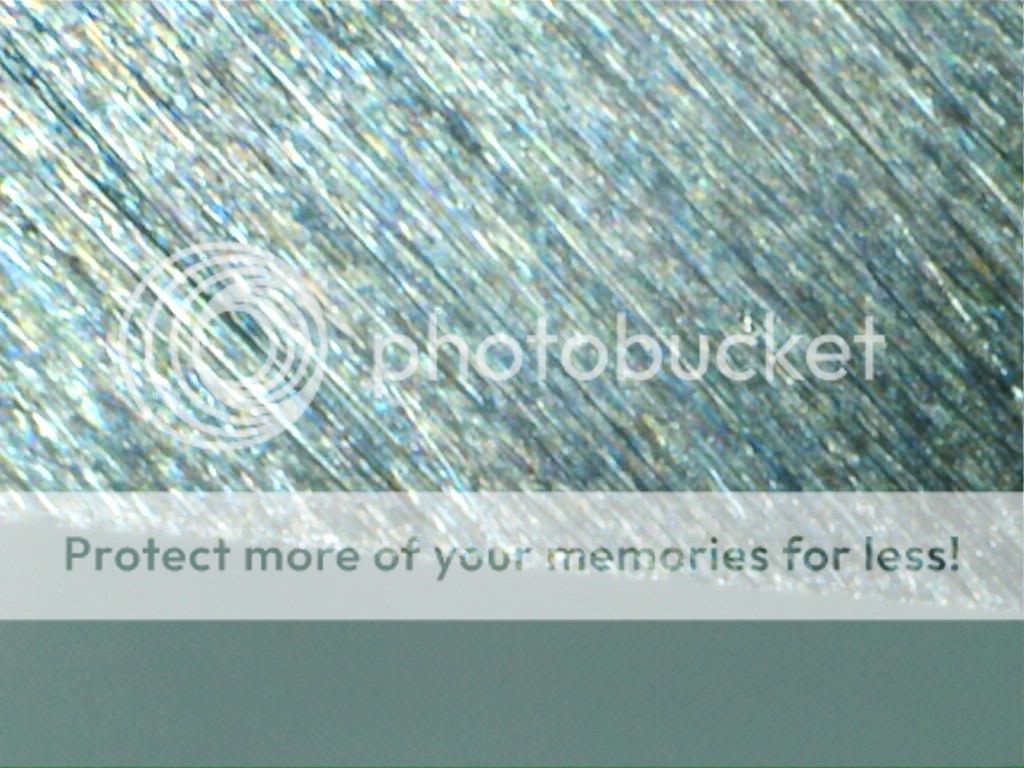

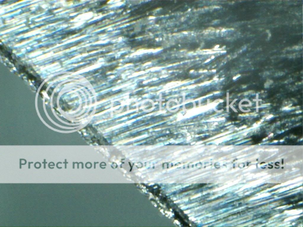

I offer a sharpening service. I use a handheld sander, not a grinder. It has a super worn 220 grit belt, the edge it leaves is more like a 1200 grit but with some deeper scratches. I am pretty experienced at freehand sharpening and get a back bevel to about 16-17 a side. I then do a micro bevel on the sharpmaker at 40incl, I am very careful at this stage, and depending on the steel, the edge will be hair splitting at that stage. I then Strop on plain denim for a few passes to straighten the edge, then a loaded strop for 5 passes per side, and back to denim. It leaves an easily hair splitting edge, several more strokes and it loses bite, but depending on steel, will be able to shave your face. I charge $5 NZD plus 50 cents an inch... for you Americans, that is 4 dollars + 40c an inch. For the customers who appreciate a beautiful edge, I will reprofile on a sander, then use a guided sharpener (that I made) and put a mirror polished bevel on it, with a microbevel to make it stronger and add bite to the knife. I charge 10NZD + $1 an inch...so about $8 plus 80 cents an inch.
Hope that shows you that some people do it very good :D.
Btw, I dont let it overheat, I do 1 pass on the sander at a moderate speed pass, then the other side , by the time I change sides (slowly) it has cooled most the way. I wait 10 seconds about ebery 5 passes to let it cool all the way, even though it is barely warm
Hope that shows you that some people do it very good .
