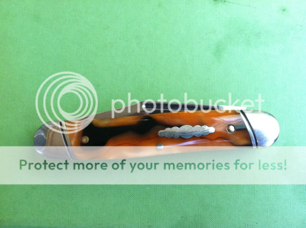

I just received a new GEC 66 jack, it's a sweet knife but has a minor issue I would like to fix. Both the tips the on clip and pen blades stick out of the handle just a hair, enough to snag my skin when running my finger over it. I don't want to wait for it to be fixed through warranty, I'm hoping I can do it myself. Anyone have a link or how-to directions to lower them down?Well I took the kicks to some 180 grit sand paper and it lowered the blades enough, problem solved. My concern with the clip blade is that the kick was already kind of small. in time I'll be able to tell if the blade is resting on the spring, thanks for responses.

Yes there is!!!! To raise a blade, "peen the kick" with a flat-tipped punch and a hammer. Place the flat-tipped punch on the side of the kick. Sharp but light raps/taps of the hammer will cause the punch to elongate the kick just enough to raise the blade. Easy does it with frequent checking is called for.
Being a novice, is it not true you can file the kick down too much and it will cause a real problem? Trying to learn here...

How do you think GEC would fix it? They'd judiciously file/sand/grind the kick until the tip of the blade rode within the frame. Doubtful that thye'd replace it - my .02¢
Since it was my suggestion to send it back I'm going to chime in. A new knife with tips exposed can get nothing but worse as it's used and sharpened. I'm sorry but I personally consider it a major design flaw or manufacturing flaw. Just my opinion.

And when GEC got it,they would gladly file down the kick and return it. No manufacturer or Quality Control is perfect. Hence the Lifetime Warranty. Just my opinion.
I don't expect perfection when I'm buying knives from manufacturers, they aren't custom knives and aren't going to be custom quality. In my opinion it's the small flaws and imperfections that are easily fixed by the owner that makes the knife more "yours" so to speak. I will say that GEC's quality is head and shoulders over the competition and you can't beat their quality-price ratio. On the other hand, if I would have sent it to them I have no doubt it would have been taken care of.
They are a relatively small company though, and don't have a specific repair department. They fit in repairs between producing new knives, so the wait can be longer. Not that I would have minded, but if it's something small that I can fix quickly and enjoy now, then why not? I never intended to send the knife back, but I haven't done very many operations myself, thus this thread being created to ask what the best approach is. If there's problems down the road, I know they'll be covered under the warranty. No need to stir the pot, everything is good now and I'm very happy with the knife...
And a Beautiful Knife it is! The Pumpkin Patch Acrylic was very popular,and is very difficult to find on the market now.
