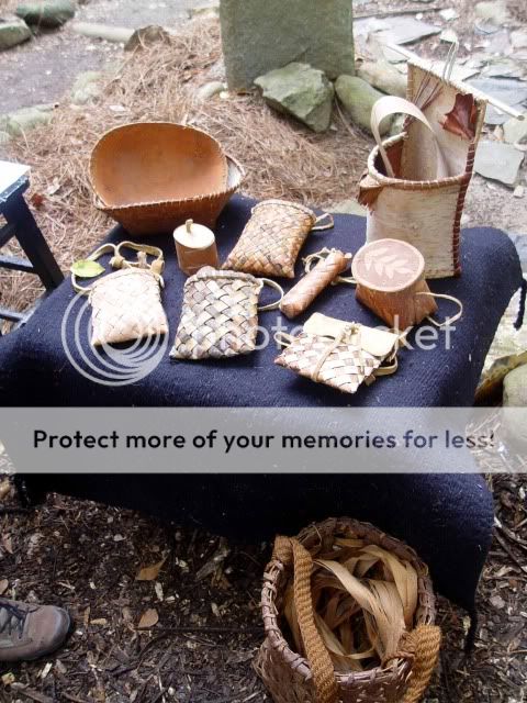

Some various examples of baskets
Enclosed is a short an brief photo how to on the use of white birch to make a pouch, using diagonal plaining. These are extremely easy to make as they basically only require one type of weave, one right over the other. The following pouch(es) utilized a 15 inch by 6 inch piece of bark, that was cut and split (delaminated) into 12 1/2 pieces plus some additional pieces.

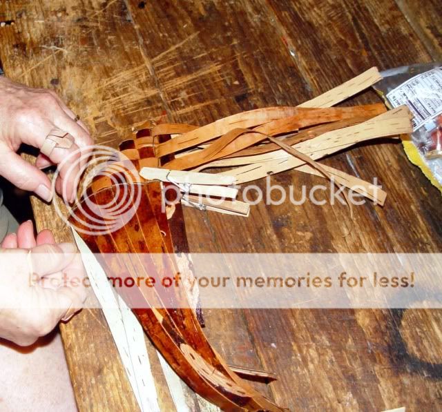

Steve Watts demonstrating the first part of the weave. It is very important to get the square as even and tight as possible.
Cordage was used to secure this square portion that will become the bottom of the pouch.
Doubled over on each corner.

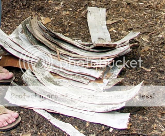

When gathering any type of bark, roll it against itself, opposite the way it wants to shape. Bark will try as hard as it can to become a tree again. River Birch/Yellow Birch is not ideal for this type of work as it does not come off in the same types of sheaths. White Birch is available commercially, but man is it expensive. I was surprised to learn that 2 foot sheets can fetch about $25. Many people up north know it too, and have special birch spots for collection of the material. You can collect it without killing the tree (go about halfway into the bark layer, dont hit the inner woody part of the tree), but the scab that forms over the spot that you harvested from becomes nasty and knotted.
Folding over and starting the overlapping process
The pouch getting there.
