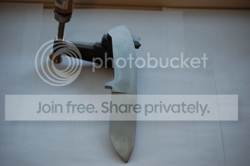

I was wondering if anyone had any tips on using a file to make a distal taper on a hunter type knife? I assume it would involve a draw filing type technique before any sanding but I'm not sure.
I have never finished a knife yet so you could say this is my first. The steel is 3/16 O1.

Looks good so far!
I think some draw filing will get you the results you want.
I use a board underneath when I'm filing and sanding to support the steel and to get a consistent finish. Don't forget to clean your file often.

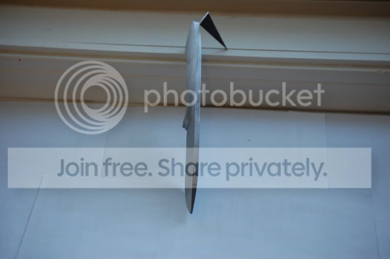

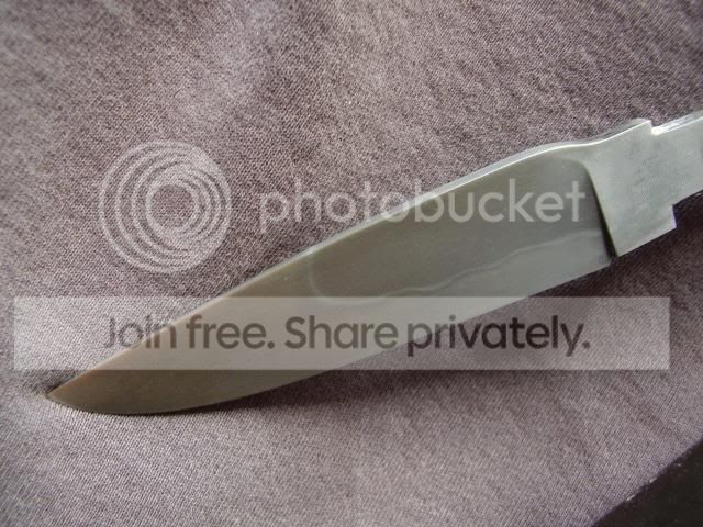

The only way i know how to do a distal taper with stock removal is to bring your plunge
cut to the top of the blade and if you keep it flat it will taper on it's own from where the blade starts to curve up to the tip.
Here are a couple of pics showing what i mean.
Bob
