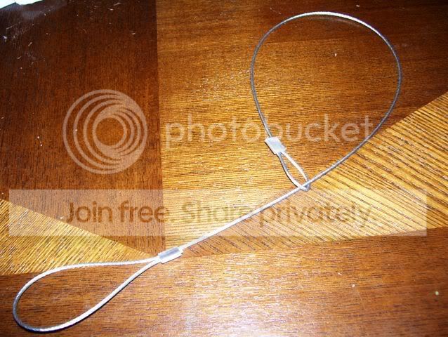

While the Guyot Standard and the Klean Kanteen are great for winter use, they lack a handle to hang them from a pole over a fire. Here is a simple solution for under $3.
Go to any hardware store and buy 1/16" stainless wire. Pick up the smallest possible aluminum ferrules and make your own. Simply cut the wire to length. I like having a 1" loop and a 3" loop with 18" in between. Pound the ferrule flat with a flat surface and a hammer.

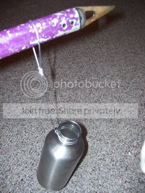

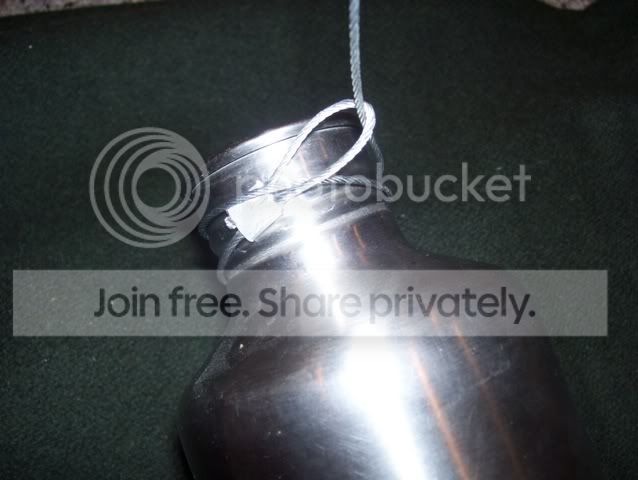

Attach to your bottle with a couple wraps and pass the larger loop through the smaller. Hang the larger loop on a suitable pole and begin heating your water!
Hope this helps!

That is a very cool idea. It looks heavier than it needs to be, though...at least for a 27 oz. capacity KK. Wonder if I can get finer wire?
This weighs nothing! It isn't heavy at all. Trust me! BTW, it is shown on a 40 oz KK.

Will it stay on the bottle when it's not under tension? Or does it wanna spring open? Either way, you can work with it. I'm just curious.
Single wrapped, it will want to spring off. Double wrapped like pictured here isn't such an issue.

I made my bottle "tether" today. I bought 3 ft of 1/16" cable for 75 cents. The aluminum ferrules were the same (from Lowes.) Mine is an inch or so shorter than Kevin's, and it weighs .3 ounces. What a great idea!

This works really well, but I will tell you what happened to me my first time doing this.
I used to use a 2.5'' copper pipe for water, and I made a noose like this. Well when the water was done boiling I started to set the thing down and all the tension was released from my bottle and it started to tip and spin around then you naturally pull up on the wire and then things can get bad fast with hot water splashing around.
If I can make a suggestion here, dig a small hole for that hot bottle to sit in when you want to remove it from the fire. Kind of like a cup holder in the ground. Trust me on this one. Also, thin wire. Thin wire is not as spring loaded as thicker wire and does not loosen up as easy when you don't want it to. It also does not hurt to have a forked stick handy to balance things out.
