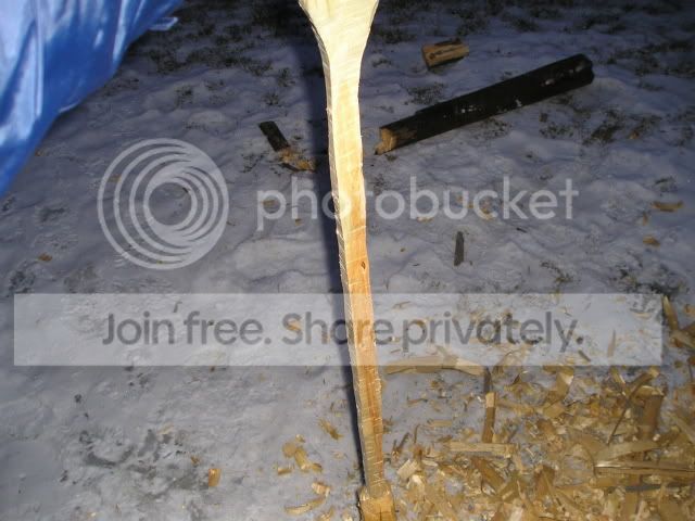

Well guys, I had some wood out back, and thought it would to do a project. The first thing that popped into mine was a paddle, but not a traditionally made one, but a one piece "quicker" version.
Now, this at total took me an hour and thirty minutes. I used my wetterlings axe along with the RC6 to see what it could do.

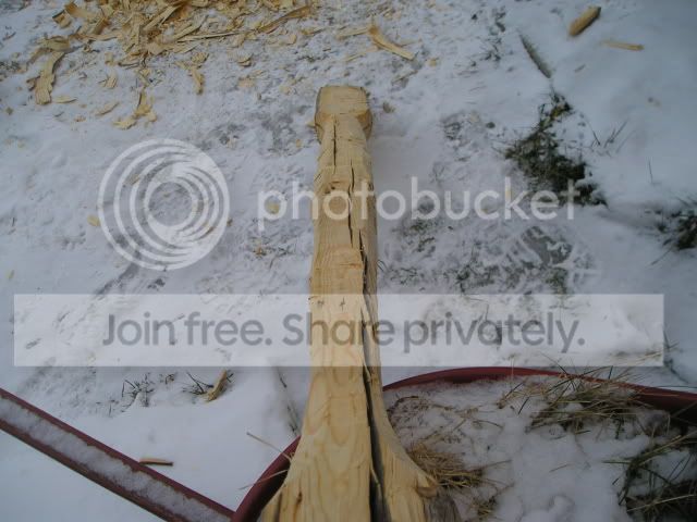

So, here is the first picture. this is after a bit oh shaping, enough to know which direction I was going.
Now as you can also see, theirs a nice crack going down the side from weathering, but it ended up not being a problem. if you were lost and need a paddle, this would work fine, not a piece of art but it would work.

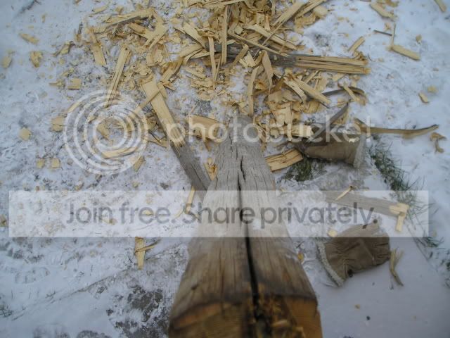

Now here were are with the general shape in order, still needs work but were getting there. this is a nice design because there is no splitting needed here, just shaping. Also, when I cut off the piece I need from a ten foot poll, I used the axe and made insanely short work of it all. this is where an axe really shines.

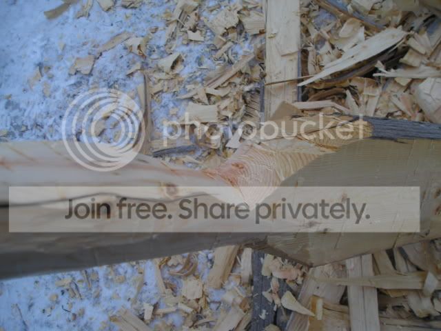

While I've only made a few of these, each one I make I like more and more. One thing I've learned is that an axe is an essential when making something like this, Im sure on softer wood, you could use a machete, but trying to do this with an over sized knife, while still possible would take hours. Even a folding saw would just be a waste of time. Here we are doing some general shaping of the head. I like the get the head area done first, then the handle then the paddle then the top of the handle.

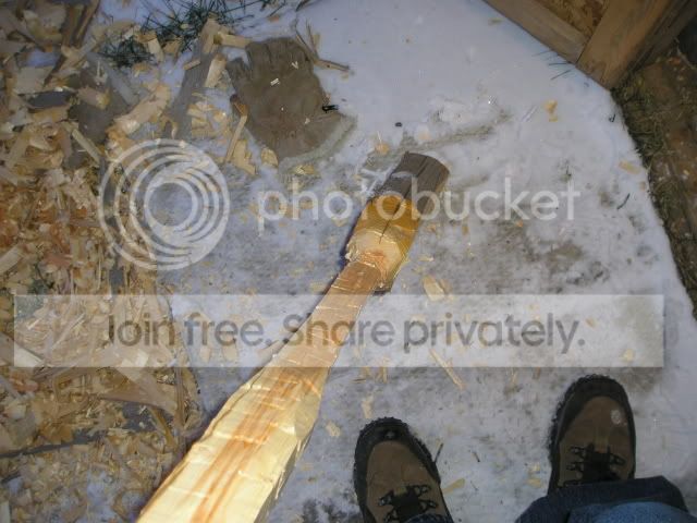

Now we have most of the shaping done here, still needs work for sure though,

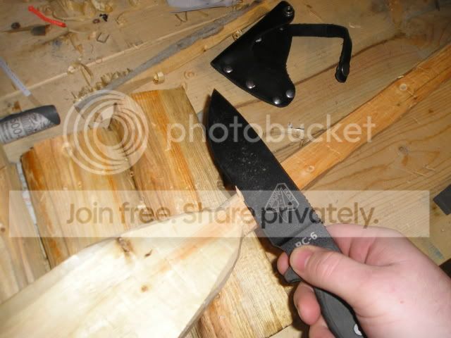

Now all the shaping I was going to do last night. After this stage some shaving is needed with a knife. Now a draw knife and a crooked knife would have been the best here, and even the axe would work, but I had the RC6 for some finishing work.
So as you can see the RC6 has a good time with some shaving, not the best but it worked. I would have like to have this knife convexed, or another convexed or scandi style edge for this work.

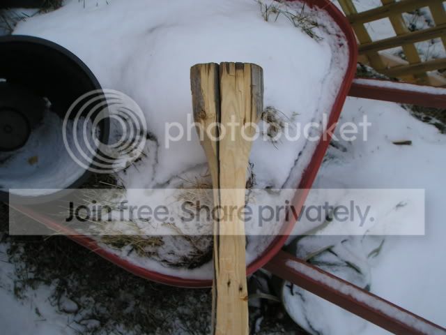

Now here are some handle shots to show how it came out over all.

So there ya go guys, I think it came out pretty nice, not the best looking but it would work. If I were out and were worried about the strength of something like this, you could all ways add some pine tar, or birch sap to seal it. Over all though it would work fine, this could use some more thinning as it still has some heft to it.

based on that big check, i probably would have split the piece twice, to make a sort of board, and then worked from there.

In this case the shaping of the paddle was essential, If I were to try and split would have crack in an uncontrolled matter. It the log was a little thicker, and not as dry then splitting would have worked. Also splitting would have taken a fair amount of time long.

I always split the board out of the center portion of a log with wedges. Just leaves me less carving to do and alows for a thinner paddle.
Again, that usualy is the best bet, but this piece had too many cracks going through it and it would have made the splitting process uncontrollable.
