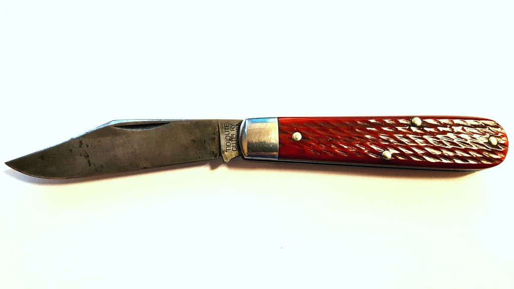

I'd recommend sticking it in your pocket and carrying it and use it as a worry-stone whenever you can get away with it. It will not polish the bottom of the jigging, if the jigging is coarse. I did it to my STJ which has pretty aggressive jigging. The "peaks" are very shiny but the "valleys" in the jigging are still kind of matte. Sorry, no pics of that one, but here's a shot of my heavily carried 15, the bone is extremely glossy on this one form carry - quite a bit shinier than when I got it:
