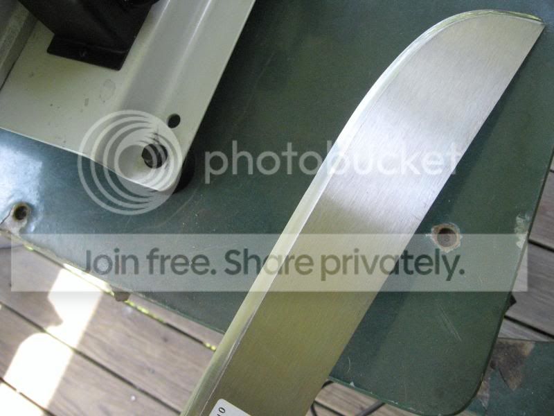

Tramontinas and even Moras can be convexed. Of course, you wouldn't do a full convex edge (spine to edge), but at an appropriate angle for the machete. I usually stick fairly close to the original primary grind angle. Here is a new Tramontina 18" I just did.
I used an 80 grit to set the profile, then went to a 80 micron 3M finishing belt. I finished with a 15 micron belt.
Haven't noticed anyone mentioning it yet so I'm going to have to butt-in and remind everyone to keep a bucket of water handy to dip the blade into whenever the blade starts getting warm. Removing so much metal on a belt-sander without controlling the heat can ruin the temper of a knife .
convexed my 12'' tram today, as well as reshaped the handle a bit, (all with the same belt!:D) worked beautifully. I would have liked a bit finer finish on the edge but it's not bad considering it was 80 grit. Ordered a bunch of belts from lee valey too. It must be a major PITA changing belts all the time.;)
