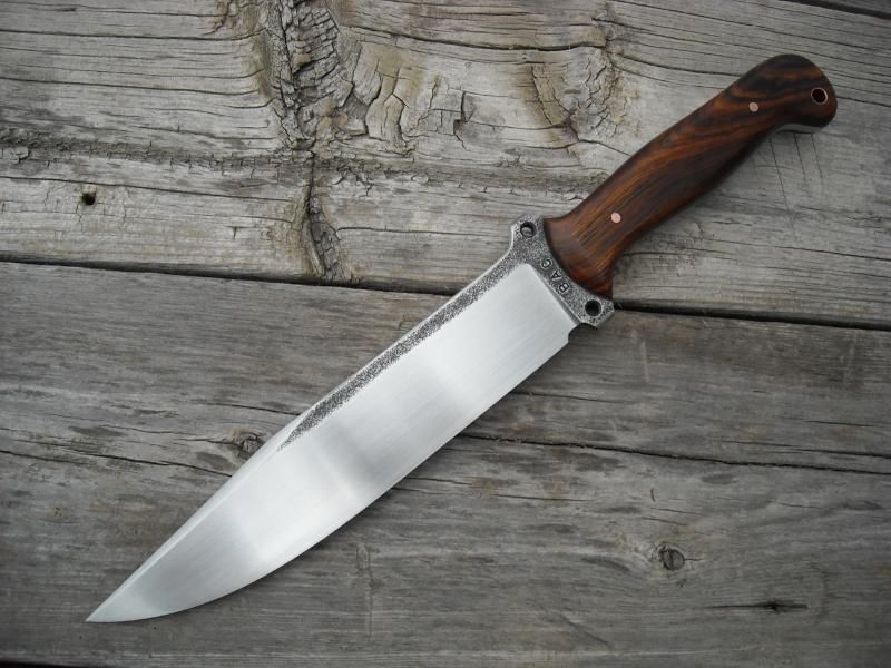

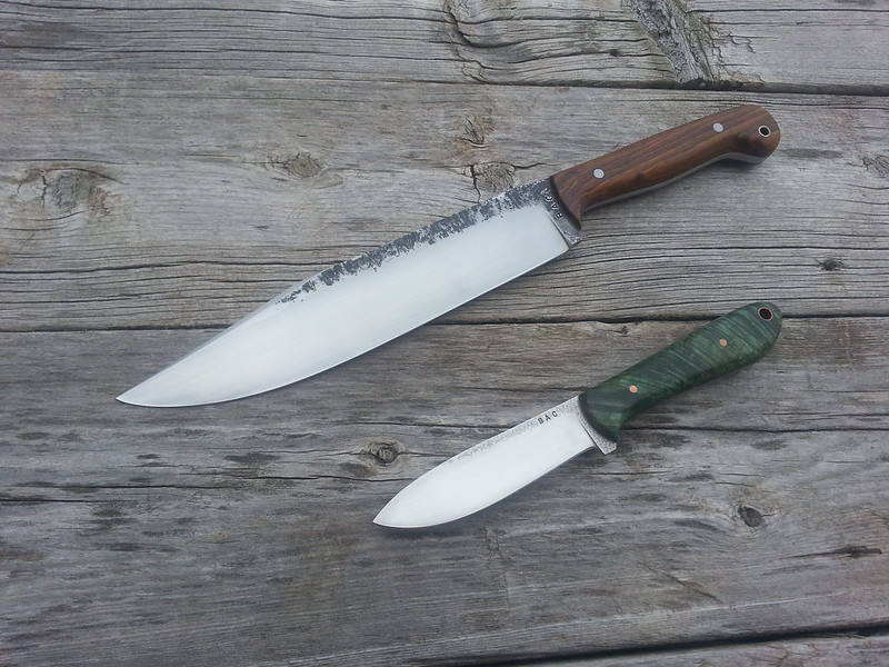

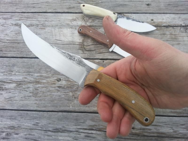

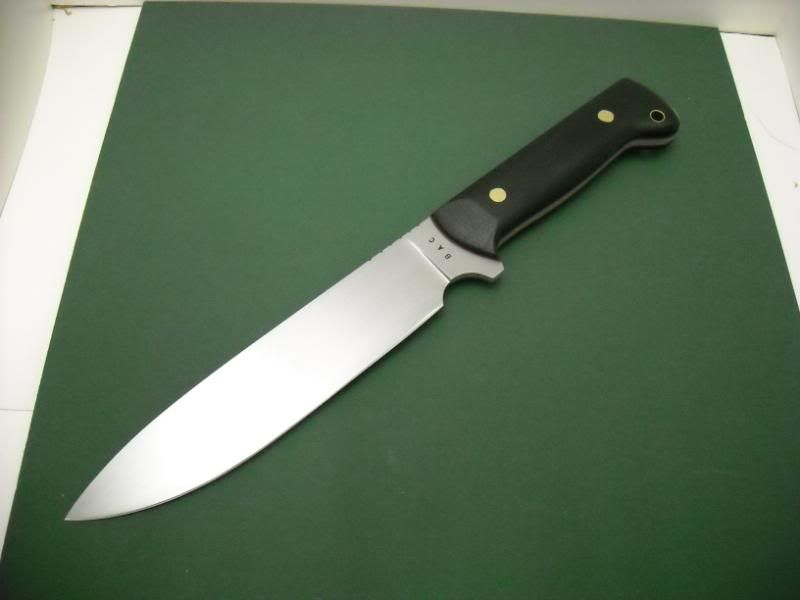

Here are a few camp knives that I made (7-8" blades):
A CPM 3V skinner with a curved handle, thumb ramp and finger choil:

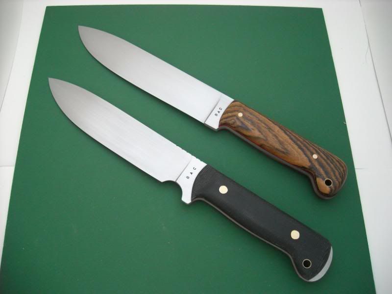

Bushcrafters (top one is 1084, bottom is CMP 3V):
Untitled by bruce culberson, on Flickr
For a corrosion resistance and tough steel I would recommend 3V. Personally I wouldn't taper the tang on an exposed tang knife as it leaves you with a thin striking surface.
